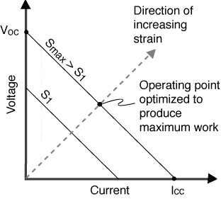

Well, they sell a PIEZOELECTRIC ENERGY HARVESTING KIT with this spec:
Closed Circuit Current per sinusoidal cycle, at rated deflection. ± 57 (microApeak/Hz)
