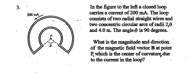

Diagram of a closed loop of wire made of two radial straight segments joined by two concentric circular arcs, with current 200 mA marked on the outer arc, a point P at the centre and the angle θ = 90 degrees marked at the centre.
dB = (μI/4π)(dLsinθ/r^2)
the flat edges of the loop will not contribute to the magnetic field because sinθ = . Only the curved outer loop with radius I will call r2 and length L2 and inner loop with radius r1 and length L1 will contribute.
[itex]B = \int_{0}^{L_2} \frac{μI(dL)}{4π(r_2)^2} + \int_{L_1}^{0} \frac{μI(dL)}{4π(r_1)^2}[/itex]
[itex]B = \int_{0}^{270°} \frac{μI(r_2dθ)}{4π(r_2)^2} + \int_{270°}^{0} \frac{μI(r_1dθ)}{4π(r_1)^2}[/itex]
[itex]B = \frac{μI}{4π}(\int_{0}^{270°} \frac{dθ}{r_2} + \int_{270°}^{0} \frac{dθ}{r_1})[/itex]
[itex]B = \frac{μI}{4π}(\frac{270°}{r_2} + (-\frac{270°}{r_1}))[/itex]
[itex]B = \frac{μI(270°)}{4π}(\frac{1}{r_2} - \frac{1}{r_1})[/itex]
[itex]B = \frac{μI(270°)}{4π}(\frac{1}{4} - \frac{1}{2})[/itex]
[itex]B = \frac{μ(.2)(270°)}{4π}( - \frac{1}{4})[/itex]
[itex]B = -\frac{μ(.2)(270°)}{16π}[/itex]
and by the right hand rule I think the direction would be into the page. Is my method correct?
Yes, the method and the direction seem correct. I have not inspected the calculations.
( 270° = 3/2⋅π )
Thank you! so not converting to radians will give me an incorrect answer?
You wrote three quarters of the circumference of a circle as ##\int r dL##, right ? Would you settle for 270 r or do you think it should be ##3/2\; \pi r## ?
I am not sure. I am guessing it should be in radians?
