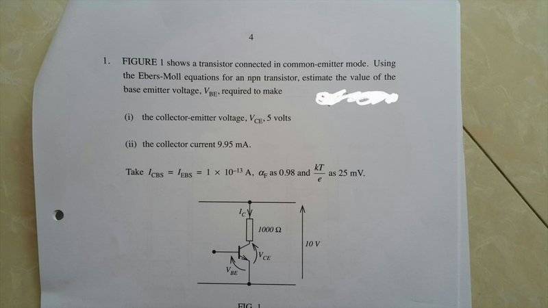

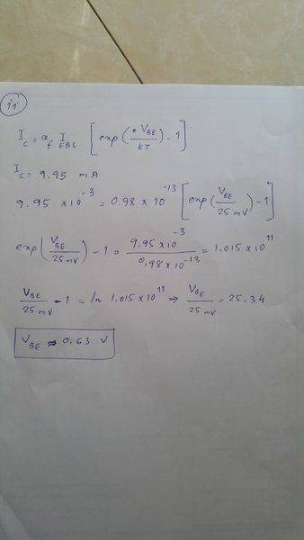

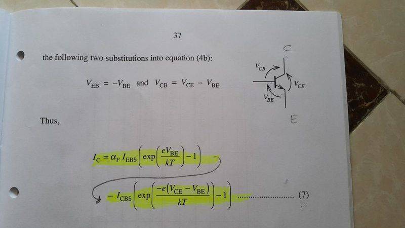

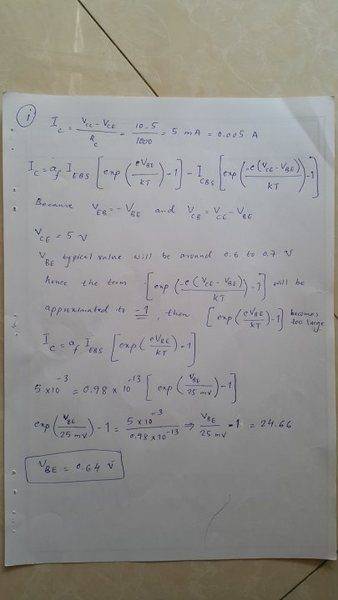

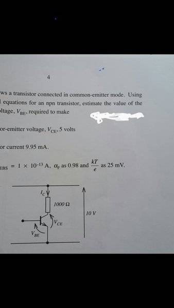

Hi again dear friends. , hope all are doing well.
Please could some one evaluate my work and advise me in case any correction is required.
Have a good day
Hi Falcon, did you already try a calculation backwards?
That means: To insert the results for Vbe into the orignal equations?
No
If you advise me to do that , then I will do it.
What about the formulae and method I have chosen, are they correct?
falcon555 said:
No
I must admit that I did not check the whole calculation (extensive and hard to read).
Therefore my recommendation. I think, such a calculation backwards is a simple method for confirming the result.
