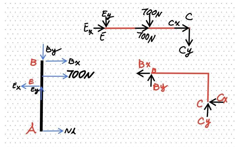

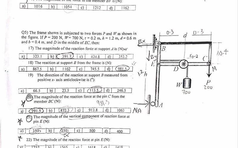

Can you check my free body diagrams for the whole frames
$\sum F_y=0,\sum F_x=0$
can you check if I sketched it correctly?
And please if you know any good resources refrence it.
Welcome, @YehiaMedhat !
It seems to me that P is missing, as well as location of D.
Note that for the armature not to collapse, the L-shaped element BC must be rigid and resisting an internal moment.

YehiaMedhat said:
More explanation please.
The joint where B and C meet is the only rigid joint in the structure. Can you not see how the whole thing would just fold downwards against the wall if BC is not rigid?

Clarification:
You don't need to put any internal force on the sketch, as a FBD only shows external forces on each member.
That includes force P, which you have not shown.

Sorry about the induced confusion.
I just tried to imply that the L=shaped member BC could be replaced with a straight string, rope or chain, without affecting the static balance of the armature.

In these problems, the first step is to treat the armature as a solid regarding forces and reactions acting on it.
For that, you use the three equations of balance of x-forces, y-forces and moments that you know.
In that way, you can find the values of the reactions (at points A and B in this case).
You can then use those calculated values to solve the rest of the questions in the problem (forces at connections of links).
