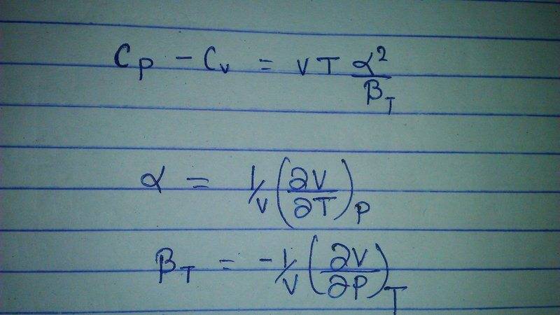

Apply this formula you will get the result

Hello @Chestermiller If you are referring to post 13, it is interesting, but he doesn't show the origin of his equation, and I believe it to be incorrect. It is also dimensionally incorrect, if I'm not mistaken.
For the OP @Pushoam and @Abhishek kumar I believe this equation (post 13) is incorrect. See my post 14. I think the equation in post 13 is not even dimensionally correct.
Sorry to say this Charles, but I agree with the result in post #13. It is essentially the same as your result in post #14.
My mistake with the dimensional analysis. It's going to take a little work to show the two are equivalent though.

V=V(P,T)
dV = ??
then, set dV = 0
I just got the result. It's easier than I thought it would be. Will show it momentarily... ## \\ ## ## dP=\big( \frac{\partial{P}}{\partial{T}} \big)_V dT+\big( \frac{\partial{P}}{\partial{V}} \big)_T dV ##. Setting ## dP=0 ## allows one to take ## \big( \frac{\partial{V}}{\partial{T}} \big)_P ##. The hardest part was actually writing out the Latex. :)

Dear Chestermiller posting correct formula is not allowed?i haven't posted complete solution how can you warn me?
Please see his post #15. I can't speak for him, but I think he changed his mind. He might not have been able to cancel it.

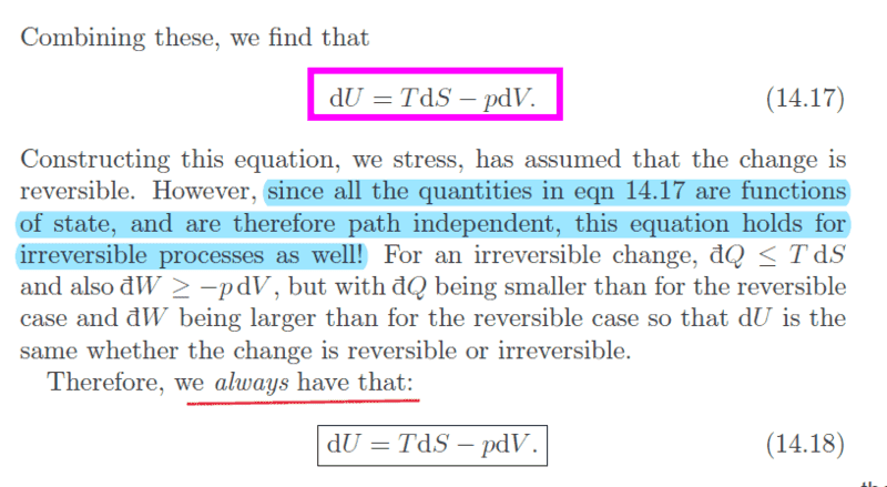

I have to find out ## C_P - C_V = \{\frac{\partial U} {\partial V} +p\}\frac{dV}{dT}##
For ##C_V##, I have to calculate ##\frac{\partial U} {\partial T}##. It is not needed to calculate ##C_V ## for this problem,
but this gives me the idea that here, U is a function of two variables V and T.
Not getting how to calculate ## \frac{\partial U} {\partial V} ## from dU = T dS - pdV, I thought of using Maxwell's relation.
So, I take that potential which is a function of V and T i.e. Helmholtz function F.
F = U - TS
dF = - pdV - S dT
Maxwell's relation gives,
## \frac{\partial F} {\partial T} = -S
\\\frac{\partial F} {\partial V}= -p
\\ \frac{\partial S} {\partial V}= \frac{\partial p} {\partial T}
\\ \frac{\partial U} {\partial V} = \frac{\partial F} {\partial V} + T \frac{\partial S} {\partial V} = -p +T\frac{\partial p} {\partial T}##
Is this correct?
Thank you for discouraging me from Wild guess. Wild guess simply wastes time.Doing further calculation,
##\{\frac{\partial U} {\partial V} +p\} = p\{ 1+ \frac {bp}{RT^2} \} ##
## \frac {dV}{dT}= \frac 1 p \{ 1+ \frac {bp}{RT^2} \}##
So, ## C_P - C_V = \{\frac{\partial U} {\partial V} +p\}\frac{dV}{dT} = {\{ 1+ \frac {bp}{RT^2} \}}^2##
Here, I have taken U as a function of V and T. So, V and T are independent variables.
While calculating ## \frac {dV}{dT} ##, I have taken V as a function of T keeping p constant. Isn't it wrong?
Shouldn't I take ## \frac {dV}{dT} =0## assuming U as a function of V and T and so V and T independent variables?

Now, that's what I was looking for. Congratulations. We're proud of you. You've transformed from a wild guesser into a Scholar. Keep up the good work.
