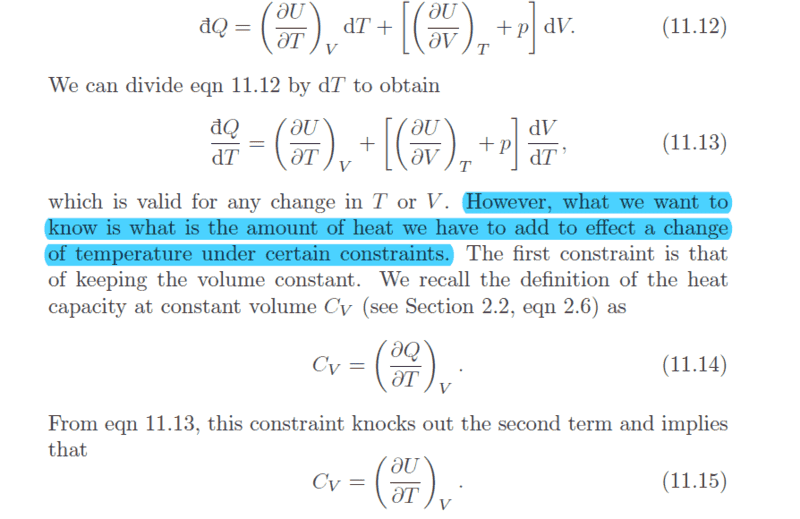

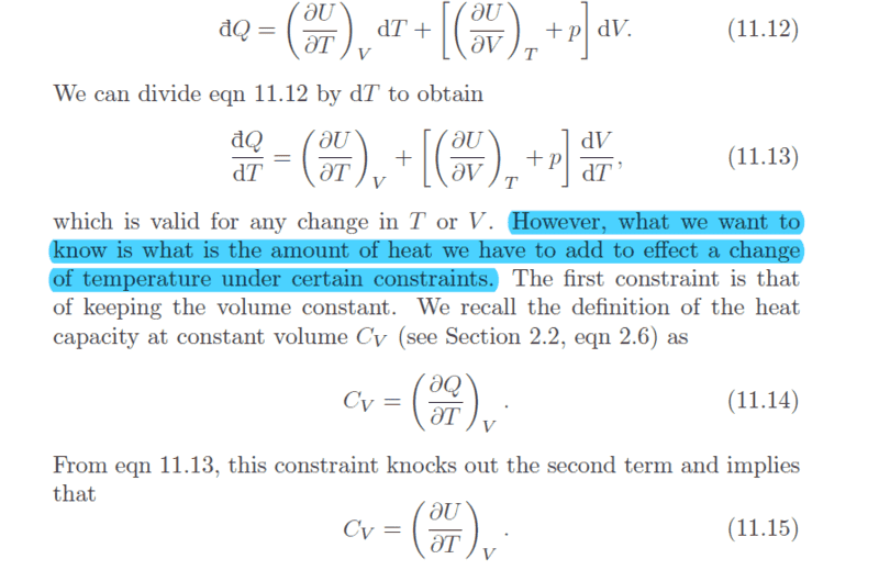

As Q (heat)is not a state function, we cannot express it as a function of state variables.
But then doesn't the eqn.
##dQ = \left ( \frac {\partial U } {\partial T } \right) _{V} dT + \left ( \frac {\partial U } {\partial V } \right) _{T} dV + p dV## tell that Q is a function of V and T?
##\left ( \frac {\partial Q } {\partial T } \right) _{V} =C_V## means that Q is fn of V and T, dosn't it?
A partial differentiation is defined only for a well defined function. If Q is not a fn of V and T, then Q is a fn of which variables?
If Q is not a well - defined fn, then how do we calculate heat given to a system for a given process?
Actually, Q is well - defined. The point is : the value of Q is different for different process. Q is a process dependent fn or path dependent fn. So, when the path is given, Q is defined. For ##\left ( \frac {\partial Q } {\partial T } \right) _{V} =C_V## , the process is an isochoric process, and hence, for this process, Q is a function of T. Is this correct?
I myself am getting confused here. So sorry if it doesn't make sense what I am writing here. I will take another try. I may be then able to formulate better where I am stuck.
This equation is not valid for an irreversible path. That is because, unless the path is reversible, the work is not pdV. Moreover, it is always a bad idea to write a thermodynamic equation in terms of differentials unless the path is reversible. Even then, this equation would be valid only for the change between two closely neighboring equilibrium states. Plus, if you took two different tortuous reversible paths between the same two closely neighboring equilibrium states, in general, the total Q and the total W could differ between paths; they would just be nearly equal to one another for each path.
No. The correct relationship is ##\left ( \frac {\partial U } {\partial T } \right) _{V} =C_V##. U is a unique function of V and T for equilibrium states, not Q.
Q is the amount of heat added from the surroundings to the system, irrespective of whether the process is reversible or irreversible? Check your textbook and see how Q is calculated for various processes. Sometimes it is specified in the problem statement, sometimes it is backed out of the first law (knowing the work and the change in internal energy), and sometimes it is determine from the change in the surroundings internal energy. It is never calculated from a change in V and T.
This is one of the cases in which is it backed out from the first law ##\Delta U##.

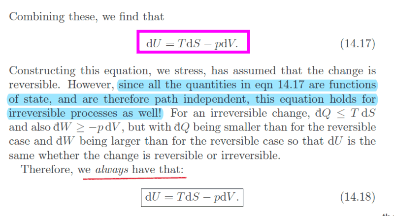

Pushoam said:
dQ = T dS for a reversible process.
Since both S and T are state - fn.,T dS is same for each path. Hence, the if we integrate TdS between the final and initial states, the integral i.e. Q also should be independent of the path. Does this mean that Q is a path - independent function for a reversible process?
This is not correct mathematically. We can create many Carnot cycles in which the temperatures at which heat transfer occurs are the same and the change in entropy is the same (zero), but for which the net heat transferred is not the same.
  • #47
The above equation comes from the 1st law of thermodynamics ( ##\Delta U = \Delta Q + \Delta W ##)which is valid for ( I think ) both reversible and irreversible processes.
For reversible process, U as a function of V and T and dW = - p dV are defined. So, the above equation is valid only for reversible process. Right ?

The book says,
Here, ## C_V ## is defined as ## C_V = \left ( \frac {\partial Q } {\partial T } \right) _{V} ## and then on calculation it is found that ## C_V = \left ( \frac {\partial U } {\partial T } \right) _{V} ##.
What I have understood from your statement as ## C_V ## is defined as ## C_V = \left ( \frac {\partial U } {\partial T } \right) _{V} ##.
Is this correct?

The book says that for reversible process both TdS and pdV are differrential of state fn. So, their definite integral i.e Q and W respectively should also be state fn. But, it is said that Q and W are not state fn. This is where I am stuck.

The book says,
Is this correct?
I completely disagree with how this is presented in your book, and, as justification for this disagreement, I cite your present state of confusion.
In freshman physics, they taught us that ##Q=C\Delta T##, where they called C the heat capacity of the material and Q the heat transferred to the material. All the problems to which this was applied were ones in which no work was done.
Now we arrive at thermodynamics, and we encounter situations where work can be done on the surroundings. And immediately we encounter problems with using this old definition because Q is supposed to be (exclusively) the heat transferred from the surroundings to the system, while C is supposed to be a physical property of the material. And, when work is being done, Q is not longer equal to ##C\Delta T##. So, in thermodynamics, we find it necessary to discard the old definition of C in terms of Q, and adopt a new definition in which we consistently get the right answer, whether or not work is being done, while, at the same time reducing to the old definition when work is not being done. This new definition is:
$$C_v=\left(\frac{\partial U}{\partial T}\right)_V$$and $$C_p=\left(\frac{\partial H}{\partial T}\right)_P$$These new definitions clear up all the difficulties with Q being energy in transit (specifically for a process) while C is a physical property of the material (independent of any process).
Q is not the definite integral of TdS and W is not the definite integral of PdV. This is only true for a reversible path. For an irreversible process, we can only know T at the boundary of the system (typically an ideal reservoir temperature, ##T_R##), and, for such a process, the most that we can say is that $$\int{\frac{dQ}{T_R}}\lt\Delta S$$where ##\Delta S## is the change in entropy between the initial and final thermodynamic equilibrium states of the system (i.e., assuming that the final state is an equilibrium state). And, for both reversible and irreversible processes, $$W=\int{p_{ext}dV}$$.
Here is an article I wrote for Physics Forums Insights that I wrote a couple of years ago that might help: https://www.physicsforums.com/insights/understanding-entropy-2nd-law-thermodynamics/
