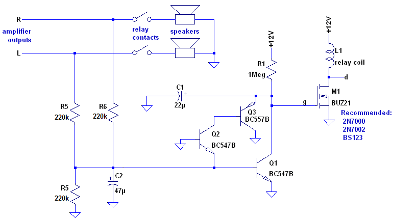

Hi all.
I am using LM311 comparator to design a speaker protection circuit. I read quite a few data sheet of LM311. Seems like it's such an old IC that they assume people know the IC already. I happen to be a first time user and I am not sure I design it right. Mainly strobe pin #6. From reading, it seems like if I use a transistor to pull it down, the output transistor turns off regardless and become open circuit pulled up by the pull up resistor. Also the output transistor how I can use it off ground. Anyone that familiar with the LM311, please confirm I designed the circuit correctly.
Also, this is a speaker protection circuit for SS amp that can drive a DC voltage if something gone wrong. This circuit will:
1) monitor the output by using a low pass filter to filter out the audio frequency, only the very very low frequency or DC passes through. Two window comparators using LM311(U1 & U3, U2 & U4) are used to monitor the DC and turn off the transistor if over 0.7V DC is detected.
2) monitor circuit to monitor +/-24V supply (R3, D3 and relay S1). If total voltage drop by say 5V, the relay opens.
3) Power on delay (Q1 C15). The drain of the Q1 connects to pin 6 of all the comparators. when Q1 is on and pull all the pin 6 to ground, the LM311 turns off.
The /OUTPUT EN are use to turn on the speaker output relay when it is pulled to ground.
I am connecting the two LM311 output transistors in series with the relay contact, so if anyone opens, the chain opens and loss the ground, the speaker relay will be turned off. Only if both NPN output transistor of LM311 and the relay are on, then the /OUTPUT EN will be low to turn on the speaker relay. Please confirm that I am doing everything correctly.
Thanks
Alan

Here is the latest schematic, still using the LM311. But I literally halved the circuit. The important question is still whether I use the pin #6 correctly. My understanding is if I hold pin 6 low, the output turns off. Now I am using just a capacitor C15 to hold pin 6 low when first power up. The cap will slowly charges up and release the LM311 after a delay.
Please let me know whether I designed it right on the LM311.
Thanks

Yungman - glad to see you're back !
per http://www.ti.com/lit/ds/symlink/lm111-n.pdf
I do notice that pin 6 will output a few miliamps. Will that upset your timing via C15 R7 ?
I'd add a series resistor because there is an all transistor path from pin6 to V+ and to V-,
and there's a pin6< (V+ - 5volt) absolute maximum rating that it looks like you'll exceed on powerup. See schematic on page 19 of datasheet, probably Vbe on Q7 i'd guess.
I sure like the idea of power supply asymmetry protection. And DC to speaker.
old jim
Do you really need the speed of LM311? Fast comparators always cause me trouble.. I'd find a way to use LM324...

I decided to use Jony130's circuit in post #6, but with modification to have separate transistors Q1 and Q2 for each channel. The resistors summing for the two channels forms voltage divider that raise the voltage for the trigger to over 1.4V, that's too high, I want to keep it below +/-1V.
I gave up the LM311, the pin 6 is hard to use, need to have too many components to create power on delay.
Thanks

I modified the circuit. I separated the two channel, lower the resistance and up the capacitance to get more current.
My speaker is 4ohm, very expensive. I want trigger at 0.7V.
Non-polar cap ?? Are you sure you need them ? Notice that Q1 and Q2 will clamp the voltage across the cap. So the capacitor voltage will never be higher then +/- 0.7V.
And as you should know all electrolyte capacitor can handle -0.7V for a short period of time (typical 1 V maximum reverse voltage).
And why you add R3 (510k) resistor ??
It's safer to use non polar cap, for 16V, it's cheaphttp://www.digikey.com/scripts/DkSe...q=635623666083054091&CSRT=7150203582344528301.
R3 is to make sure the PNP turn off when not being pulled. I like to have the circuit crisp, I use higher current to make sure the beta of the transistors are more optimal, when turn off, I use resistor like R3 to discharge the Vbe of the PNP. I don't want to save circuit components, I want it to be clean. I would have still go with the LM311 if not because the pin 6 is kind of funny and the data sheet is not clear. It wants you to pull pin 6 low, BUT not to ground. I don't want to deal with this kind of "grey area" stuff.
