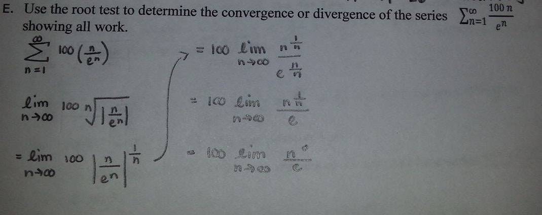

Hey,
I am working on this problem over the root test but I am not sure if I am doing it right. I will attach my work to this thread and I really want someone to look over my work and see if I am doing it right. By the way I didn't finish the problem because I was not sure where to go from my last step. Thank you!

I would agree that using the root test, we need only look at:
$$L=\lim_{n\to\infty}\sqrt[n]{\left|\frac{n}{e^n}\right|}=\frac{1}{e}\lim_{n\to\infty} n^{\frac{1}{n}}$$
I would next focus on:
$$L_1=\lim_{n\to\infty} n^{\frac{1}{n}}$$
If we take the natural log of both sides, we obtain:
$$\ln\left(L_1\right)=\lim_{n\to\infty} \frac{\ln(n)}{n}$$
From this, can you now determine $L_1$, and hence $L$?
