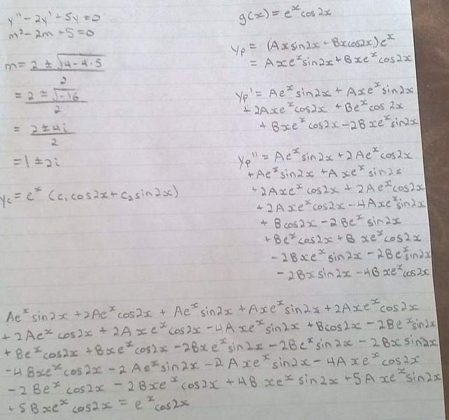

$$y''-2y'+5y={ e }^{ x }cos2x$$
I still haven't completed the question but I just want to know if I'm on the right track. It's becoming ridiculously tiring to just complete 1 question.
Is it supposed to be this long?

There are many different methods to solving differential equations, you may or may not have learned very many of them at this point.
What method are you using right now?

I am currently using the method of undetermined coefficients.
First I solve the homogeneous version of the differential equation to get the complementary solution. Then I guess the form of the particular solution and try to find the unknowns.

Your homogeneous solution ##y_c## looks wrong. Where did the roots of the characteristic equation go?
Also, your guess for the particular solution ##y_p## is also incorrect slightly. Why do you have an ##x## in there? I don't see any polynomial terms in ##e^{ x }cos2x##?
If this is a textbook problem, I can't imagine it being that horrible. Are you specific told to do undetermined coefficients? If not I'd try other methods and see if they work any better.
I used the following to get the complementary solution:
$${ m }_{ 1 }=α+iβ\quad \quad { m }_{ 2 }=α-iβ\\ y={ e }^{ αx }({ c }_{ 1 }cosβx+{ c }_{ 2 }sinβx)$$
##e^{ x }cos2x## is already in the complementary solution so I have to multiply the particular solution by x:
$${ y }_{ c }={ c }_{ 1 }{ e }^{ x }cos2x+{ c }_{ 2 }{ e }^{ x }sin2x$$

Ah yes, I see what you did for ##y_c## now. My Euler formula is a bit rusty lol.
Your ##y_p## also looks fine now that the ##y_c## is confirmed.
You seem to be making solving the coefficients from your guess for the particular solution unnecessarily difficult. It's a bit messy, but why on Earth are you expanding all those terms instead of collecting those with the same coefficients together?
[tex]y(x)=(Bx\cos(2x)+Ax\sin(2x))e^x,\quad y'(x)=((B+2Ax+Bx)\cos(2x)+(A-2Bx+Ax)\sin(2x))e^x,\quad[/tex]
[tex]y''(x)=((4A(x+1)+B(2-3x))\cos(2x)-(A(3x-2)+4B(x+1))\sin(2x))e^x[/tex]
You substitute and divide by ex to get
[tex](4A(x+1)+B(2-3x)-2(B+2Ax+Bx)+5Bx)\cos(2x)=\cos(2x)[/tex]
and
[tex](-A(3x-2)-4B(x+1)-2(A-2Bx+Ax)+5Ax)\sin(2x)=0[/tex]
(sine and cosine are independent) This has to hold for any x, so the coefficients must be the same – The sine term has to vanish, and the coefficient of the cosine term has to be one, so
[tex](4A(x+1)+B(2-3x)-2(B+2Ax+Bx)+5Bx)=1[/tex]
and
[tex](-A(3x-2)-4B(x+1)-2(A-2Bx+Ax)+5Ax)=0[/tex]You get B easily from the second one (again, it has to hold for any x, just simplify) and then A from the first one. Can you take it from here?

Sweet. I solved it. Factoring the terms like you said reduced the 6-line juggernaut shown in the image I posted to only 2 lines.
Thanks.
