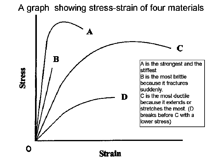

For a perfectly rigid material the modulus of elasticity ##E## is infinite thus the strain ##\epsilon## is defined by ##\epsilon= \frac{\sigma}{E}= \frac{\sigma}{\infty}##. Hence, for any value of stress ##\sigma##, the strain will always be zero. So you can see that the stress is still present, it is just that any value will result with the same strain. Even if such material doesn't exist, one can always assume it would still have a maximum strength, i.e. a value of stress for which it would break.
Compare to the following stress-strain curves, a perfectly rigid material would have a vertical line aligned on the stress-axis, stopping at some maximum value.
