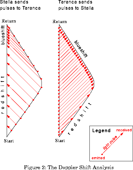

I was thinking though that if you take the diagram showing the doppler shifting:
Two spacetime diagrams side by side: left, Stella sends pulses to Terence with blueshift near Return and redshift near Start; right, Terence sends pulses to Stella with the same labels. Red light-pulse arrows and a legend are shown.
and run the calculations, based on distance and a constant speed of light, to transform the diagram into showing where the rocket WOULD have been when the light was emmitted from Earth you'd see the second, blue lined, simultaneity diagram?
If that is true then what i was trying to suggest is that simultaneous events, during turnaround, are occurring over a larger span of Earth time than rocket time (longer section of the CT axis).
The recording of the video, and editing it based on those calculations, was a way of observing those simultaneous events occurring in 2 frames, in one single frame. ie, the video will run for the same duration as the rocket trip, but the frames (video frames) displayed will render Earth in slow motion, then fast-forward during turnaround, and back to slow motion at the end of the tape.
Hence, seeing the Earth in the 'calculated' future, based on a calculated rendition of the trip rather than an actual observed trip.
I wonder if that makes more sense?
  • Two spacetime diagrams side by side: left, Stella sends pulses to Terence, with red light pulses and a blueshift and redshift labelled; right, Terence sends pulses to Stella, with the same labels. Each shows Start at bottom and Return at top, with a legend for light pulses.
These lines don't transform. They show all the events that, in a so-called "momentarily comoving" inertial frame, would be considered simultaneous at some time.
Or, simpler, what - for the rocket - happens at a certain time anywhere in the world. The diagram itself is plotted in Earth coordinates, you can directly read off where the rocket is at any instant -according to earth. There, simultaneous events are on horizontal lines.
It is most importan that simultaneity means different things for different observers.
Simultaneous according to the rocket! These events aren't simultaneous acoording to earth.
I think so, especially as it makes clear how artificial this generated "experience" is.

Thanks a lot for the help. Rather than trying to depict the 'reality' of events, i was trying to conjur a scenario that i could use in order to verify that the diagrams represented what I thought they did.
