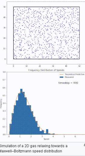

I (mechanical engineer) have researched this question but can't get to an answer.
The equilibrium condition for confined particle diffusion of a solute in a solvent is reached when the solute spatial density is uniform (= zero density gradient), and entropy is max.
But per Boltzmann, when confined particles reach equilibrium, a non-zero energy gradient) persists indefinitely, even as max entropy is reached.
My assumption here is that both are cases of diffusion - one of species, one of thermal energy.
If both processes are cases of diffusion, why, at max entropy, does solute diffusion reach a zero density gradient, but energy diffusion reaches a non-zero energy gradient?

Boltzmann predicts that a non-zero range (= distribution, = gradient) of particle energies will persist "forever" in the steady-state. Since this is an energy-diffusion process, why do the particle energies not "diffuse" to a single uniform value for all particles the same way a solute/solvent particle density gradient diffuses to zero in the steady-state?
That is not correct. A non-zero gradient means that there is a change when you look at another position.
The distribution as found comes out as a result of averaging and is not position dependent: the outcome is the same in all places. Ergo a zero gradient.

@SteveMaryland: forget about the heat death of the universe for the moment. Are you familiar with energy conservation? (That orbits of closed classical systems are confined to a constant energy "level set"?) From a purely classical perspective, the Boltzmann distribution emerges from a sort of "diffusion" over a space that very closely resembles the constant energy surface (modulo ##O(N^{\alpha})## additional conserved quantities, where ##\alpha < 1##), after projecting the resulting uniform distribution over that surface to a (much) lower-dimensional subspace. Consider the uniform distribution on a sphere: after projecting it onto a 2D cross section, is it uniform? No: instead, it looks something like ##\rho(r) \propto \frac{1}{\sqrt{1-r^2/R^2}}##. Something similar happens in higher (i.e. ##N\sim 10^{23}##) dimensions, modulo subtleties pertaining to how "well separated" the dimensions are from each other in the Hamiltonian (i.e. you can anticipate the Maxwell Boltzmann distribution for a dilute gas coupled to a thermal solid along a smooth boundary, but it's slightly more difficult to guess an a priori accurate, effective, statistical mechanical Hamiltonian for, say, the Na ions in salt, ignoring the Cl ions and valence electrons.)
There are many systems in nature that satisfy the conditions for thermodynamic equilibrium, at least to reasonable precision, and many systems that do not. Usually (but not always), a macroscopic system that isn't in equilibrium in its entirety can be thought of as consisting of small unit cells that are each in local equilibrium, and to some extent vice versa (you might find it interesting to come up with a few criteria that might determine 'local thermodynamic equilibrium'.) For example, in fluid mechanics and dynamical models of phase-transitions, it is often assumed that a local temperature is well defined for each infinitesimal control volume even though there might be significant heat gradients over large scales; because heat spreads diffusively over short distances, the equilibration time scale tends to decrease rapidly with length scale.
