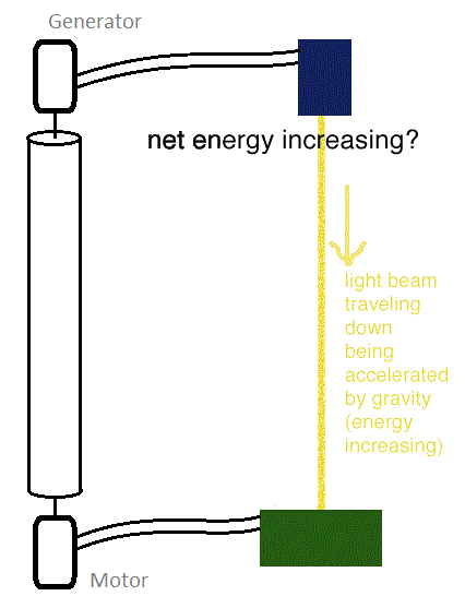

  • #31
Please bear with me.
Obviously I haven't read all the books you have, and I do not have all the related knowledge.
I have read a bit by now of your references, but I can't say I get and understand all of it.
bcrowell said:
So I think the right way to think about this is that we need to stop talking about rigid-body rotation in a uniform gravitational field, which is a kinematical impossibility.
You say here that rigid-body rotation in a uniform gravitational field is a kinematical impossibility.
But how can that be?
I'm pretty sure we can have a rotating body that is rigid in the sense that we normally call rigid (from a practical point of view and passing by on Born-rigidity).
We can let it rotate at non-relativistic speeds.
Since we have a difference in height there will be almost imperceptible GR effects.
How can this be a kinematical impossibility?
Or rather, what do you mean by that exactly?
  • #32
bcrowell said:
Maybe you haven't read the statement of the Herglotz-Noether theorem carefully? It doesn't just say that angular acceleration is impossible, it also says that linear acceleration with nonzero angular velocity is impossible.
1) There is no linear acceleration in #25
2) There is no angular acceleration in #25
I elaborated earlier that the system is in equilibrium so we can ignore all forms of acceleration, so I fail to see the relevance of the
bcrowell said:
in this example.
bcrowell said:
It doesn't predict anything about the measurements you described in #25, because it says that the setup you've described in #25 is kinematically impossible.
I do not see how you can conclude that and your claim can be falsified by a simple experiment that anyone can do in there own home. Place a motor and power supply on the floor of your garage. Connect a 1 metre vertical shaft to the motor and connect it to a a generator. Switch on the motor. If the motor and generator turn the power is turned on, then your claim is falsified because angular acceleration and rotation IS POSSIBLE even when a gravitational field is present, as it usually is in your garage or anyone else's garage for that matter. So why do you say the example is kinematically impossible? It clearly is not impossible in real life and if the Herglotz-Noether theorem predicts that it is impossible for a motor and generator to have angular acceleration or rotation when there is a difference in gravitational potential then there is something clearly wrong with the theorem or the interpretation of it. Valid theories should agree with what is observed in real life, no?

  • #34
Just for everyone's information, guss duplicated the original post of this thread midway through another thread in the general physics forum: https://www.physicsforums.com/showpost.php?p=3383001&postcount=37 Duplicative discussion of the same problem has been going on in both places. I've closed the other thread. Folks who have been participating in this one may want to pick through the other one for good ideas, and vice versa.
  • #35
bcrowell said:
Maybe you didn't read the second paragraph of #26 carefully?
Here is the second paragraph of #26:
bcrowell said:
Suppose your shaft is in a uniform gravitational field. This can be made into a flat spacetime by changing to a set of coordinates defined by a free-falling observer. To this observer, the shaft is violating the Herglotz-Noether theorem, so it can't be Born-rigid.[/url]
One definition of Born rigid motion is that spatially separated points on the solid body remain stationary and the same distance apart according to accelerating observers at rest with the accelerating body. This excludes your free falling observer. In the classic case of a rod being artificially accelerated with Born rigid motion in flat spacetime, the observers on the rod observe no change in the geometry of the rod, but a non accelerating Minkowski inertial observer would say the accelerating rod is getting shorter. In the example I gave in #25 with the vertical rotating connecting shaft, observers on the rotating shaft and at rest with it would say all points of the shaft remain at constant distance apart over time and therefore the vertical rotating shaft has Born rigid motion.
There is nothing impossible about the set up in #25 and it could easily be done in any lab. You might disagree with what the scientists might measure, but to say it is impossible to set up the experiment is silly.
  • #36
Here is how to set up the experiment described in #25:
In Stage 1 the light source is connected to a stored energy source.
1) The electrical energy is converted to electromagnetic radiation energy. (Impossible?)
2) The radiation energy is converted to electrical energy. (Impossible?)
3) The electrical energy powers a motor which starts rotating. (Impossible?)
4) The vertical shaft starts rotating. (Impossible?)
5) The mechanical rotation of the shaft powers a generator. (Impossible?)
6) The battery is disconnected and the electrical output of the generator is connected to the radiation source. (Impossible?)
We have arrived at Stage 2 and essentially the situation in #25.
Which step are you saying is physically impossible?
In stage one the vertical rod is undergoing angular acceleration and observers on the shaft would not say that it is undergoing Born rigid acceleration, but this is of no consequence to the crux of this experiment. At stage 2 when the battery is disconnected, there is no further angular acceleration and after the set up achieves equilibrium, observers on the vertical shaft agree it has Born rigid motion.
Now I agree that 100 percent efficiency is impossible to achieve in principle so we could retain a small power input from a battery at stage 2 to make up for mechanical losses. The important thing is that we should both agree that there is no net production of excess energy (over unity) as result of the gravitational effects and hopefully you will eventually agree that by maintaining the system at an equilibrium of constant angular rotation, that the measurements made by the observers would agree with those given in #25.
Possibly you are saying that 100 percent efficiency is impossible and that is reasonable, so for the sake of argument let us say that the efficiency at each energy conversion stage is 99.9%. Let us say further say that at the end of Stage 1 the battery is not disconnected but its output is reduced to a level that maintains constant angular velocity in the system and the energy output of the motor is measured. Would you agree that the energy output from the motor at the top is less than the energy put into light source from the battery? Would you agree that the rpm measurements of the observers at the top and bottom would agree with what I stated in #25 to within a few percent?
  • #37
BTW, there was a mistake in the way I originally wrote it, but it's not relevant to the point we're discussing here. (Changing coordinates doesn't change the curvature, it changes the field.)
Just because one way of stating the definition of Born-rigid motion involves a certain type of observer, that doesn't mean that once a Born-rigid body is introduced into a scenario, all other observers become invalid.
Well, of course it can be set up, but the rod won't be Born-rigid. It will flex and deform as it rotates, and this will dissipate heat, causing the transmission of the energy up the shaft to be less than 100% efficient. In a real-life realization of your setup, this general-relativistic effect will be ridiculously small -- much too small to measure compared to effects like frictional heating in the bearings. But the paradox only derives its interest from the idea that it seems like a perpetual-motion machine. The machine is claimed to amplify the input energy by a certain factor 1+ε with each cycle; ε=gh/c2 due to the gravitational Doppler shift of the falling photons. In a real-life setup, we'd have ε~10-16, which is much too small to be practical. When you say that it's "silly" to deny the impossibility of constructing the setup, you're right in the sense that the deviations from rigidity required by relativity would be extremely small, but the whole analysis is an analysis of extremely small effects, in a thought experiment that obviously isn't practical.
  • #38
I added a paragraph to my last post which you might have missed which partly addresses your concerns here. In the example I gave the redshift was a factor of 2 which far from insignificant. In principle (near a black hole) we can make the redshift factor as large as we desire (eg 100 or 1000) which should be sufficient to overcome mechanical losses. Remember, this is a though experiment and we are talking about what we would measure in principle.
Simplify the experiment even further.
Let us say we have an energised motor low down in a gravitational well. It is connected to a long vertical rod (but no generator or light sources). Let us say the motor reaches an equilibrium terminal rotation speed of 1000 rpm as measured by a local observer. Assume a mechanical and conversion efficiency of greater than 99% (not impossible in principle).
Would you agree that the observer at the top would measure the top of the shaft to rotate at 1 rpm if the redshift factor was 1000?
Would you agree that the observer at the top would measure the both the top and bottom of the shaft to rotate at 1 rpm?
Would you agree that the observer at the bottom would measure the both the top and bottom of the shaft to rotate at 1000 rpm?
(All the above, give or take a small (relative to the redshift factor) efficiency loss).
  • #39

  • #41
In this situation, the deformation and heating effects I described in #37 would be very large, and the rod would be vaporized.
It would depend completely on the physical properties of the rod. The rod can't rotate Born-rigidly under these conditions.

  • #43
Choose a rotation velocity and gravity potential difference where the rod does not vaporize. I really get the impression you do not want to see the "big picture" here.
As I understand it, SR forbids a material with infinite tensile strength, but you seem to be forming your own conjecture/theorem that GR puts a much lower limit on the hypothetical tensile strength of any possible and maybe as yet undiscovered tensile. This conjectured limit of your new theorem is coincidently aligned with the impossibility of measuring relativistic differential time dilation or differential angular rotation of a vertical rod in a gravity field.
Bear in mind that in the Pound–Rebka experiment, the scientists were able to measure time dilation effects over a vertical distance of just 22 metres. I would bet that a few years before the experiment that most people would have thought it impossible to measure gravitational time dilation over a distance of 22 metres in the Earth's gravitational field. Do not under estimate the ingenuity of scientists when it comes to measuring very small effects!
I wonder why you find it difficult to discuss this thought experiment in a "in principle" basis. Is there something about my conclusions that make you uncomfortable? In this forum, we often discuss experiments in an "in principle" basis, such as a rocket ship accelerating to 0.8c in one second or a rocket cruising at 0.99c and objecting to the conclusions on the grounds that is impractical or expensive is just petty and small minded.
  • #44
What seems to be overlooked here is that despite what is written on the diagram there is no increase of energy when the photons move.It is true that the energy of the photons themselves might change but these changes are accompanied by changes in the gravitational potential energy of the system, the total energy being conserved.

  • #47
This thread is not about a perpetuum mobile.
It's about understanding how energy conservation works in GR and to improve the understanding of the accepted laws of physics.
The perpetuum mobile drawing is only a means to show in the simplest possible way that the energy must balance.
This is opposed to a machine, in which there must be a flaw somewhere, which may not be evident immediately.
A machine that seems to be intended to show that the laws of physics are wrong.

I must complain that everyone is changing Guss' 'original' specification to an interesting conundrum they like but gets way too technical for me, and which doesn't come close enough to the original to answer it in an intuitive and transparent way.
Guss has specified a photon emitter. I will deal with it one photon at a time.
His assembly of gears is an assembly of levers and fulcra, and we can simplify that to the instantaneous case of a vertical lever and fulcrum. When we're finished we can re-assemble it as multiple gears again, because what is happening amounts to the same.
I will assume a (theoretically possible?) perfect momentum absorber as his energy converter at the bottom.
One photon bangs into the absorber at the bottom of the lever and sends a transverse wave up the lever. This is the crux of the matter: the impulse is mediated by the bonding force of the covalent shared electron bonds of the metal of the lever, and the bonding force is electromagnetic, whose associated particle is the photon.
I humbly submit that the wavelength of the photons involved at bottom and top of the lever are correlated with the wavelength of the photon moving down from top to bottom, and the net energy gain is zero, and a fortiori, any mechanical assemblage that moves energy from bottom to top is going to have the same symmetrical configuration.

yuiop said:
Here is a simplified version of the original problem:
Assuming 100% efficiency and assuming the light is blue shifted by a factor of 2 on its way down, then if the motor at the bottom is rotating at 1000 rpm measured locally, the generator at the top would rotate at a rate of 500 rpm measured locally. This would cancel out the apparent energy gain of the light traveling downwards. The observer at the top would see both the motor and generator as turning at a rate of 500 rpm and the observer at the bottom would see both the motor and generator as turning at a rate of 1000 rpm. If this was not the case, the connecting shaft would eventually break.
If the observer at the top sent a synchronisation signal down at a rate of once per second and the observer at the bottom synchronised his clock with the signal from the top, both observers would agree that the top and bottom of the connecting rod is turning at 500 rpm and that the apparent increase in energy of the falling photons is just an artefact of the difference in clock rates of the unsynchronised clocks and that there is no actual energy gain.
Well since I'm here, might as well add my 2 cents. yuiop I believe you are not quite right here, but no-one else has picked it up so here goes. Take a trip down memory lane - here to be exact: https://www.physicsforums.com/showthread.php?p=3026387.
We both got it initially wrong, ich in #5 gave the correct answer. Power top vs bottom goes as the square of redshift - not only are the individual photons blueshifted bottom re top, but their rate of arrival also. And thus vice versa when it comes to translating mechanical power from bottom to top in your setup. The redshifted motor shaft speed is correct, but since power = angular velocity x torque, one must find the torque redshifted equally. Since by the Schwarzschild coords lateral dimensions and thus shaft radius is invariant wrt potential, this boils down to the azimuthal forces acting on the motor rotor must be redshifted. In another thread I used the example of a horizontally disposed dipole undergoing partial collapse, giving off redshifted radiation in the process. As the initial moment arm is an invariant there also, redshifted emission of radiation must coincide with a redshifted force of attraction between charges. This is consistent then with then a (redshift/blueshift)2 relation between power measured at the two different locales. Of course one still has to be comfortable with the motor-shaft-generator setup being an entirely general representation of mechanical power transport up against gravity. Do we agree?
I kind of agree, I still think they are talking about my problem, but I can't follow the discussion.
I *think* the original problem has been solved, but there is still disagreement. And yes, your simplified way of thinking about it is better.
By the way, how is the energy of te photons not increasing? They are being pulled down by gravity, thus their mass should be increasing, no? If not, that should be beside the point (not that I am not interested in the fact that I'm wrong about the photons).
The point is to evaluate the movement of mechanical energy against gravity.

  • #59
I didn't follow most of the discussion either, but here's what I got out of it (simplified thinking style :smile:).
The mechanical contraption is indeed subject to GR.
At the bottom the gravitational potential is lower, meaning more time dilation.
The difference in time dilation is responsible for the apparent loss of energy when going up.
And moreover, this same time dilation is also responsible for the blue shift of the photons going down.
  • #60
I agree that your downward photons increase energy. Perhaps I gave another muddled explanation. But transmitting energy through a mechanical means will go through that little song-and-dance I gave that I'd hate to repeat. There is no simple way of explaining it; it would require a new post giving all the details by an expert.
The glue particle of electromagnetism is the photon, it is the exchange particle of the electromagetic force. No wave, phonon, impulse, twist, etc. can travel without these mediating photons acting at every step. With each step up the gravity gradient, the exchange-photon will have tad lower energy. So we're looking at single photons coming down and getting more energetic, and domino-photons, if you will, going up the gears getting weaker. As each exchange photon is emitted and absorbed a bit higher, it is a bit weaker. (They may be 'virtual' photons, for all I know. Perhaps they don't obey GR rules.)
So when you get to the top, you're right back where you started. If you rob the system of energy, then you have the classic, non-functioning, perpetual motion machine. There will be a net loss. The thing will run out of fuel.
There would be a similar problem if you just had a big vertical circuit of wire. The deBroglie waves coming down you might think would have more energy (voltage) at the bottom, but they would have less at the top.
