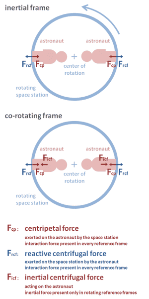

Is the concept of reactive centrifugal force valid?
The discussion revolves around the validity of the concept of reactive centrifugal force, exploring its definitions, implications, and the distinctions between various types of forces in different contexts. Participants examine the terminology used in physics, particularly in relation to Newton's Third Law and the nature of forces in non-inertial frames of reference.
  • Some participants argue that there is only one centrifugal "force," which is an inertial effect observed in non-inertial frames, and that calling it a reactive centrifugal force is incorrect.
  • Others propose that the term "reactive centrifugal force" can be valid in certain contexts, such as when discussing forces at the interface between objects, like a string and a ball, where both centripetal and reactive forces are present.
  • A participant mentions that in a rocket traveling in a circular path, the centripetal force on the rocket and the reactive centrifugal force on the ejected fuel can both be considered reactive forces.
  • There is a suggestion that the Wikipedia article implies that the reaction to centripetal force is always centrifugal, which some participants find misleading, noting exceptions in non-contact forces like gravity.
  • Some participants emphasize that contact forces are fundamentally electromagnetic, and this perspective complicates the understanding of reactive centrifugal forces in different scenarios.
  • There is a discussion about the nature of pseudo forces in rotating frames, with some participants asserting that these forces correspond to non-forces in inertial frames, while others argue that gravity remains a real force in both frames.
Participants express differing views on the validity and definition of reactive centrifugal force, with no consensus reached. Some agree on the need for clearer terminology, while others maintain that the existing definitions are adequate.
The discussion highlights limitations in the definitions and examples provided in the Wikipedia article, particularly regarding the treatment of forces in different contexts and the implications of Newton's Third Law. Participants note the need for further clarification on the distinctions between contact and non-contact forces.

They should really give the real, "reactive" centrifugal force a new name so as to avoid confusion.
Maybe, but this is not the task of Wikipedia. On the contrary: it is against their rules to invent new terms, and put them there. You have to provide references showing that a term is already in use, so I assume there are such references for the real centrifugal force.
Personally I would prefer that the inertial centrifugal force gets a new name. "Centrifugal" is simply too general to describe this specific concept. The other inertial forces in rotating frames have specific names: Coriolis force & Euler force. Bernoulli and Lagrange seem to be the ones who identified inertial centrifugal force as a pseudo force. But this is not going to stick anyway.

Or simply consider the rotating space station scenario, without any ropes.
  • #346
Exactly. Or the merry-go-round. Nothing 'massless' in those scenarios, so no temptation to invoke 'action at a distance'.

rcgldr said:
My point here is that in the case of an object not moving wrt to a rotating frame, then the centrifugal force wrt the rotating frame is the same as the reactive centrifugal force wrt an inertial frame.
Just to clarify: In this specific case they happen to have the same direction and magnitude, but this doesn't make it "the same force". They act on different objects (see https://www.physicsforums.com/attachment.php?attachmentid=38327&stc=1&d=1314480216").

Similarly, I would not characterise as centrifugal the net force of the moon on a mass on the moon's surface on a line joining the centres of mass of the Earth and moon. I gather you would call it centrifugal because technically it is away from the earth-moon barycentre.
AM
  • #354
Andrew Mason said:
I agree with your answers to the questions asked in your massless rope, and mass A, B scenario (set out post #190) except that I would not say that the force of B on A should be characterised as a centrifugal force.
It points away from the center of rotation, therefore it is centrifugal by definition.

rcgldr said:
In the case of an object not moving wrt to a rotating frame, then the centrifugal force wrt the rotating frame is the same as the reactive centrifugal force wrt an inertial frame. In this case the centrifugal force is real and the same in both frames, resulting in an outwards force exerted on whatever surface of the rotating frame that causes the object to travel in a circular path wrt inertial frame.
A.T. said:
Just to clarify: In this specific case they happen to have the same direction and magnitude, but this doesn't make it "the same force". They act on different objects.
Yes, the fictitious centrifugal force acts on the astronaut, while the reactive centrifugal force is the force the astronaut exerts on the wall of the space station. In the rotating frame, what is the force that the astronaut exerts on the wall called, is it still reactive centrifugal force? This would make sense since the fictitious centrifugal force is a single force without an equal and opposing force.
The analogy would be gravity with the astronaut standing on the Earth in a inertial frame. In this case there are equal and opposing attractive forces due to gravity between astronaut and earth. There are also equal and opposing compressive forces between the astronauts feet and the surface of the earth.
It would seem the main difference is unlike gravity, fictitious centrifugal force doesn't have an equal and opposing force. It's just a mathematical method used to compensate for the rotating frame.
