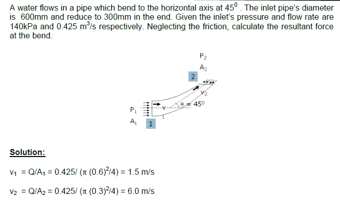

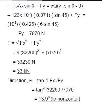

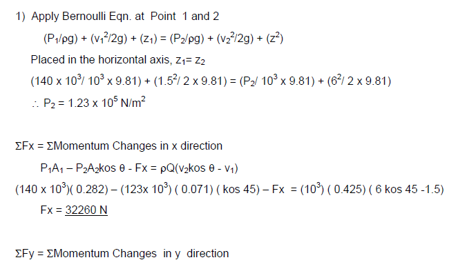

i am confused about the direction of resultant force . in the working ,it's clear that the author taking to the right as positive ,
for the force component along x-axis , we have -Fx , but , in the calclulation , we gt positive 32230N , so the resultant force of x-component is to the left(32230N ) , am i correct ?
