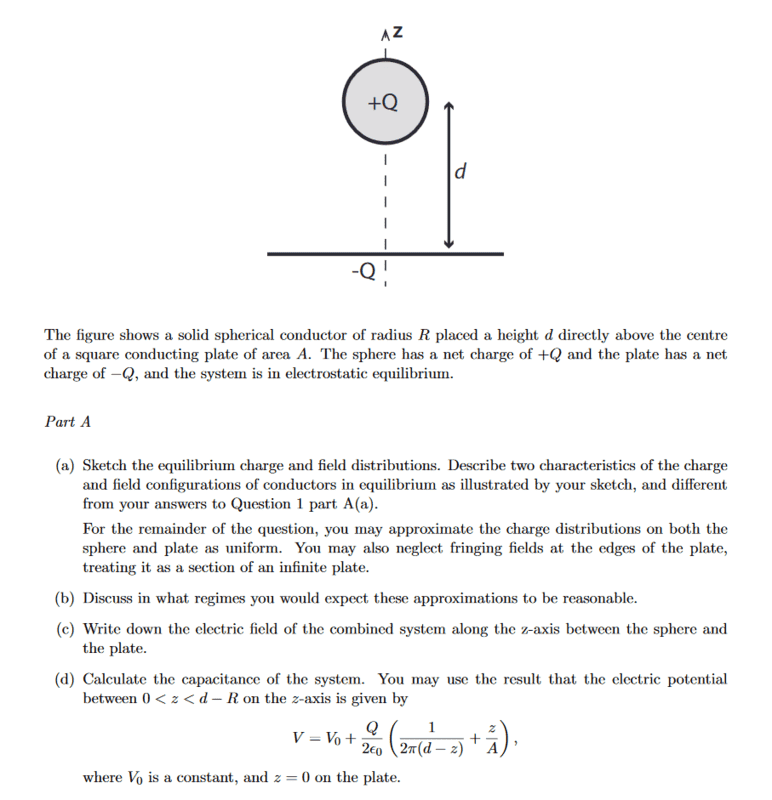

Hey, I just wanted to post these two questions to check whether the answers I've gotten are correct, as I have no real way of checking if what I've done is correct (This is for parts c and d of the attached question)
For c, would the electric field along the z axis just be the superposition of the field from a negatively charged plate plus the field of a positively charged sphere (as along the z axis the field lines are parallel to the axis)
Likewise, for d, would this be the correct way to go about solving for capacitance given the formula for potential, as I can't see any other way to cancel the Vo and express capacitance purely in geometric terms
Capacitance = Charge/Potential Difference
Electric Field of an Infinite Plate
Electric Field of a Sphere
Question
Diagram of a solid conducting sphere of radius R labelled +Q, centred a height d above a square conducting plate labelled -Q, with a z-axis pointing upward and d marked as the vertical distance between them.
