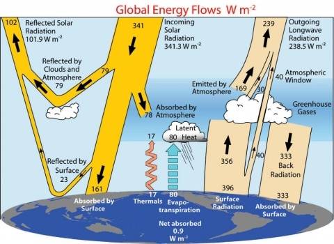

Third, there are four different levels of the atmosphere which are emitting at 240 W/m2. Traditionally, the tropopause is defined as the level where the Earth is in equilibrium with the Solar forcing - the first level where that occurs is about 4 kms up - lower than the top of Mount Everest and lower than the definition of the tropopause.
The atmosphere is transparent, to varying degrees. If you look at a thin slice of atmosphere at a specific level, it radiates almost nothing. When you look downwards, you are receiving radiation from all the levels below. The atmosphere is not a grey body. That is a useful teaching simplification to get started on some of the principles, but in general you can't actually use Stefan-Boltzmann laws. You need frequency dependent equations, or the Planck radiation laws. Here's typical spectrum of emission from the top of the atmosphere.
I've added some labels to point to various features. As you can see, the spectrum is not a simple blackbody spectrum. In some bands, the atmosphere is pretty much transparent. In these bands, the spectrum follows closely the curve for a temperature of about 288K; this is thermal radiation coming up from the surface.
In other bands, the atmosphere is almost opaque. The "saturated region" is an example, and here the curve closely follows a spectrum for close to 220K, which is the temperature of the tropopause and lower stratosphere. Basically, the only radiation in this band that can escape to space is emitted from high in the atmosphere, where it is cold. This is mainly a CO2 absorption band.
The complex behaviour on the left hand side of the diagram is caused mainly by the greenhouse effects of water vapour, which is not well mixed throughout the atmosphere, and hence does not have a simple relationship to a particular temperature. The effective emission altitudes in this band are somewhere in the troposphere.
Now in your diagram, the vertical axis is distance. Physically, it is easier to use pressure as a vertical co-ordinate, as this actually tells you the mass of the atmosphere at any level. Check out Earth Atmosphere Model, an education site at NASA. This represents the atmosphere in three bands: the troposphere with temperature falling with altitude, the lower stratosphere with near constant temperature, and the upper stratosphere with temperatures rising with altitude. In this model, the pressure tells you that about 2.5% of the atmosphere by mass is above the lower stratosphere... the region of your graph with constant temperature. Everything above that has minimal effect on Earth's energy balance. It's just too thin.
At any given altitude, you will have radiant energy flowing up, and down. As well as this, in the troposphere you have energy flowing upwards by convection, including latent heat. This is what maintains the lapse rate in the troposphere. At each level, you absorb a small amount of the radiation, and also emit a small amount based on temperature, according to the frequency dependent Plank radiation laws.
This all gets very technical in full detail, but by the time you finish chapter 4 of the text, you have pretty much what you need to explain and derive temperature profiles in an atmosphere of a given composition and with a given solar input.
