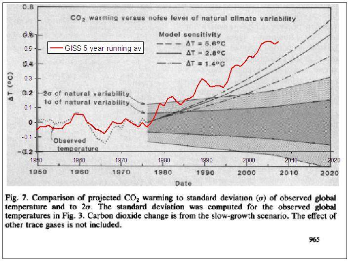

The clearest prediction and comparison with a "no trend" null hypothesis is figure 7 of the paper:
I have superimposed on top of this the modern GISS temperature record in red. Note that the measured warming exceeds what was predicted; one of the reasons for this is apparent in the figure caption. The prediction was based on slow growth of CO2 emissions, and omits other trace gases. This climate model was also comparatively crude by comparison with modern models, in particular in the way it handled the ocean. Nevertheless, it was sufficient to give a reasonable estimate for global anomalies.
I have superimposed on top of this the modern GISS temperature record. Note that the measured warming exceeds what was predicted; one of the reasons for this is apparent in the figure caption. The prediction was based on slow growth of CO2 emissions, and omits other trace gases. This climate model was also comparatively crude by comparison with modern models, in particular in the way it handled the ocean. Nevertheless, it was sufficient to give a reasonable estimate for global anomalies.
Excellent. Modulo remaining concerns about cherry-picking, this completely addresses my issue. I appreciate the effort you have given to my request.

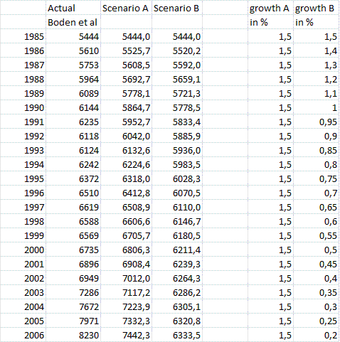

So let's talk about "flatly dishonest"
Here is http://pubs.giss.nasa.gov/docs/1988/1988_Hansen_etal.pdf
The exact greenhouse gas emissions in scenario A and B is as follows:
Note that Hansen et al DO predict based on annual emission and NOT on increase in atmospheric greenhouse gas.
We have total CO2 emission data available here with these http://cdiac.ornl.gov/ftp/ndp030/global.1751_2006.ems .

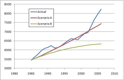

Now we can compare Hansens scenario A and B CO2 growth with reality until 2006 as follow:
Note:
All emission estimates are expressed in million metric tons of carbon.
in graphical form:

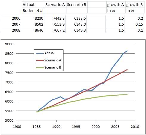

Edit / update, trying to get results for 2007 and 2008 I found http://www.pbl.nl/en/publications/2009/Global-CO2-emissions-annual-increase-halves-in-2008.html, which talks about increases of 3.3% and 1.7% for 2007 and 2008 respectively, that would update the comparing tabel and graph as follows:
So, which CO2 scenario of Hansen is closest to reality? And what was that about growing long noses?
edit: spreadsheet uploaded
Scenario B is definitely closest to reality. Ignoring your own personal graphs, which have no good relationship to what you have quoted, you can see from the actual words of the paper that they propose growth rates for the atmospheric concentrations directly.

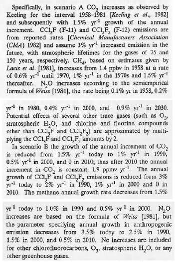

Hansen 88 Section 4.1 said:
Scenario A assumes that growth rates of trace gas emissions typical of the 1970s and 1980s will continue indefinitely; the assumed annual growth averages about 1.5% of current emissions

That is not what is stated in the paper.
Andre has clearly shown here how emissions scenario A is closest to reality. The temperature anomalies in Figure 3A are the outcomes of the model, and from this model temperature anomaly A is what we should have seen. We did not.
Afterthought: Given the casual use of ppm metrics in the paper, I have the impression that Hansen et al assumed they knew the mapping from emissions to concentration, took it as a relatively constant over this time period, and that assumption turned out to be wrong.
No, given the use of ppm metrics, it is explicit that what is being estimated is the atmospheric levels. There's no mapping from emissions to concentration used anywhere. There's no attempt to quantify emissions as a number of tons of carbon or anything like that. When numbers are used, they are always an estimate of atmospheric levels. Of course the cause for the increasing levels of CO2 are emissions, and this is why they are mentioned, but at no point in the paper are the magnitudes of emissions used, and there's no carbon model employed.
The scenarios are given directly in atmospheric levels, all the way.
The extract given by Andre is from the section of Appendix B called "trace gas scenarios". Let's walk through it, focusing on CO2, because this is the largest factor involved.
Trace gas scenarios. Trace gas trends beginning in 1958 (when accurate measurements of CO2 began) were estimated from measurement data available in early 1983, when we initiated out transient simulations. References to the measurements are given by Shands and Hoffman [1987]. ...[/color]
[Note, this is measurement of atmospheric CO2]​
Specifically, in scenario A CO2 increases as observed by Keeling for the interval 1958-1981 [Keeling et al., 1982] and subsequently with 1.5% yr-1 growth of the annual increment. ...[/color]
[Note the Keeling curve is a measure of atmospheric levels, and the increment here is obviously the annual increment of atmospheric CO2]​
In scenario B the growth of the annual increment of CO2 is reduced from 1.5% yr-1 today to 1% yr-1 in 1990, 0.5% yr-1 in 2000, and 0 in 2010; thus after 2010 the annual increment in CO2 is constant, 1.9 ppmv yr-1.[/color]
[Again; this is the increment in atmospheric CO2, culminating at a fixed rate of increase of 1.9 ppmv yr-1 which is indeed about what we have today.]​
The use of ppm is not "casual"; it's the proper unit, consistently applied throughout the paper, for the CO2 levels.
Of course the paper discusses emissions, because this is the cause of the annual increment. All the calculations in the scenario use atmospheric levels, which are indeed increasing pretty much as given in scenario B.
Furthermore... this is the scenario; it's not a prediction. The actual predictions are the response to scenarios. The paper does identify B as the most likely, but that's a secondary issue; it is not what was being predicted. The real meat of the work is the estimation of temperature response to different scenarios, which is extremely close. That is, this prediction demonstrates that the model does give credible estimates of climate response to forcing.
You and Andre and mixing up emissions with atmospheric levels in a way that the paper does not. The paper is describing quantified scenarios for atmospheric levels, which are of course driven by emissions... but there's no explicit mapping provided. Just three alternatives for atmospheric levels, of which B is easily and unambiguously the closest to what has transpired.
Cheers -- sylas
