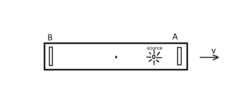

Let’s make the following experiment:
A train moves in the direction B-A where A is the front end and B is the back end. There are 2 slits at both ends. Let us make 2 arrangements:
1) The source of light is put near the front end A so as to make the light signals reach A & B at the same time relative to a ground observer
2) The train observer shuts the slit B slightly after the light reaches A but before the light reaches B
Checking the order of events relative to different observers!
For the train one:
Source emits light -> light reaches A -> B shuts -> light reaches B
For the ground one:
Source emits Light -> B shuts -> light reaches A and B at the same time
Is the order of events reversed?

Here is the set up of the experiment
https://www.physicsforums.com/attachment.php?attachmentid=44067&stc=1&d=1329562569

ghwellsjr said:
Adel, you said there was a slit at the front of the train. Why? What's it for?
Because I am still working under the effect of my previous thread (Interference pattern vs SR) :)
But u can generally assign the events to any visual effects visible to both observers

OK, one simple way is the observer at the source releases a light signal toward B to close it before starting the emission of lights toward A & B. And given his position in the train and the speed of light, he knows that B must be closed shortly after A
The scenario can only work if, as PAllen says, it's pre-arranged. There is no way for a person, or a mechanism, to wait for the light to reach A, then send a signal to shut B before the light reaches B: this would require sending the signal faster than the speed of light.
Assuming that the scenario is pre-arranged to work as you describe, there's no problem with the fact that the two events "light reaches A" and "B shuts" happen in a certain order in the train frame and in the opposite order in the ground frame. The interval between these two events is spacelike, so there is no absolute way to define which one happened first: depending on the chosen frame, the events may be simultaneous, or either one may happen first.
The same cannot be said of the two events "B shuts" and "light reaches B". The interval between these two events is timelike: whatever frame we choose, B will shut before the light reaches it.

I don't think that's a useful way to look at it. It doesn't take into account this most important point about relativity: it does not consider that "everything is relative". Certain things change depending on the point of view of the observer, but other things don't. We can say that things that do not change depending on the point of view of the observer are indeed "absolute".
For instance, in your example all observers will agree that the slit at B opens before the light hits B: the order of these two events is absolute. In contrast, the order of the two events "light hits A" and "slit at B opens" is not absolute.
