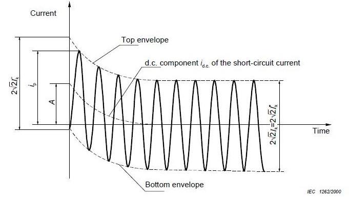

sophiecentaur: Granted your definition is the standard one for typically encountered waveforms, but to get even more picky, the following graph is located at DC Component of Asymmetrical Faults, http://myelectrical.com/notes/entryid/134/dc-component-of-asymmetrical-faults , and shows a time-varying DC component.
9XbVRp0nz_9ko7c8XQYuqGfv29fisEETw2BZDbS3v_axPxejyTIO5OmwCOHmPQnxTJMuCKKTIPaWFg=w1280-h800-no.jpg
I accept that your version of "DC component" is in frequent use (Engineers' usage would be the term I would use) but, if it is changing then it has a non zero frequency component. In a waveform such as the one you are showing, there is a clear distinction between the 'wanted' AC waveform and any offset that may occur. Also, of course, there is never a 'DC' value that goes from -∞>t> ∞ (mathematical abstraction) but the context of what 'your' DC means can be different from 'my'DC mean. If You are a 50/60HZ power engineer then your DC timescale could be tens of seconds or more. If I am an RF engineer then my DC timescale could be a microsecond (one screen's worth on a high frequency 'scope).
Look at the spectrum of your signals or my signals and there is only one DC term ( at 0Hz) but there will be a bandwidth around that value which we choose to include for our purposes.
My problem and reason for posting here was that it seemed to be implied that 'any' signal which excurses only one side of the zero line should be described as DC. That is far too simple a description. If a waveform happens to be Unidirectional, that could well be of interest in an experiment.
