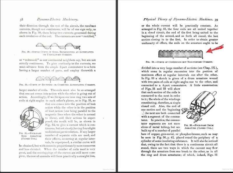

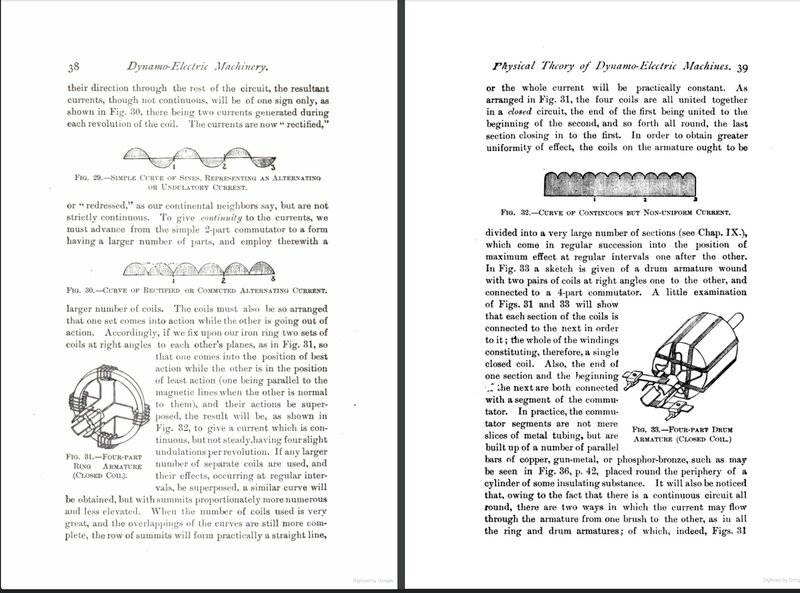

I found this old book; it shows the output as more like (how I imagine) DC, with a "ripple" on top. I guess this is what you mean by "pulsating DC?"
Dynamo-electric Machinery: A Manual for Students of Electrotechnics
Silvanus Phillips Thompson
https://play.google.com/books/reader?id=0Uk5AQAAMAAJ&pg=GBS.PA38&hl=en

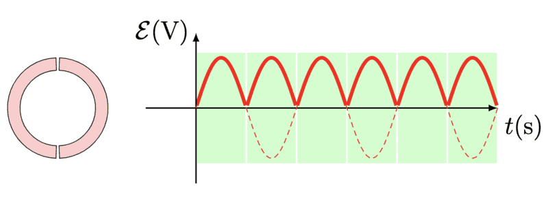

This is what happens with W. Fendt "single armature" dynamo
(the dashed line is what would happen with the "two ring" configuration of the alternator in the same animation).

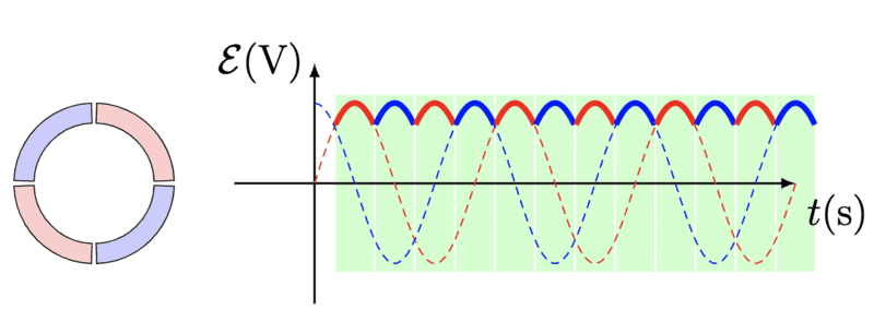

If two armatures are used, whose arc leads span 90° instead of 180°, one gets two graphs similar to the previous one.

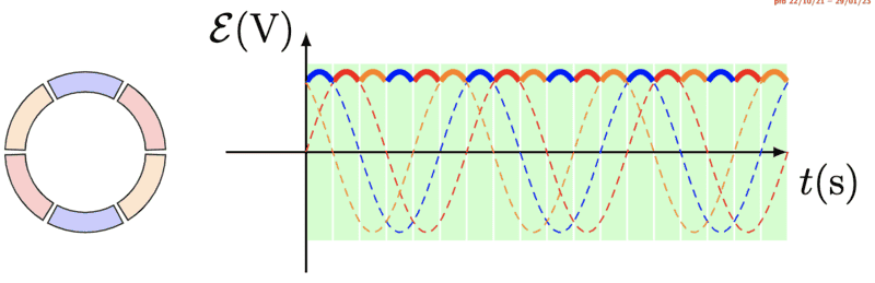

with three armatures whose arc leads span 60° the results is similar, with three graphs instead of two:
The emf is pulsed but, as the number of armature increases, the pulses become very small bumps over a constant background .
With a sufficient number of armatures the resulting current is basically continuous, and Faraday's law becomes pretty much irrelevant, whether there's an iron core or not.
