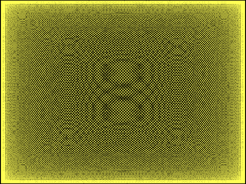

I have always wanted to set up a Lissajous figure scan pattern. The advantage there is that the beam deflections are fundamental sinewaves. The system would be more efficient because the deflection coils could be resonant. Each pixel would be scanned twice, sort of like interlaced pictures, but once on each diagonal. The outside edge would be darkened.
Select two mutually prime integers with a ratio close to the aspect ratio. Multiply those by 25 or 30 Hz depending on the 50 or 60 Hz supply frequency, so the frames repeat. The centre of the screen will then be diagonally cross-hatched.

Here is a Lissajous Raster with frequencies of 101 and 139, drawn as a yellow line on black.
Not sure why but looking at that picture @Baluncore is painful for my eyes even on a flat panel screen
There are several reasons for the crazy visual effects. A low-resolution original was drawn in pixels. That is displayed on your screen pixel grid, which shows many different sampling beats. To focus your eyes, your brain then tries to identify range and to sort out the parallax. That is why you can see many layers in 3D.
But none of that is relevant to the scan in a grid. There is only one line in that plot, with the x and y deflection being fundamental sine and cosine waves. Higher mutually prime scan frequencies would fill in the black bits, just like a normal raster.
Modulation of the line brightness would produce an image without the optical confusion in the parts of your visual brain that still remain after viewing the image.
Tuned Lissajou patterns tend to be easy on the eyes. Moire patterns baffle the eye; the perceived pain likely from muscles in the eye attempting to focus on an 'object' comprised of interference.
Though difficult to make out, the 'hourglass' shape in @Baluncore 's example is a typical Lissajou pattern. Adjusting one or both input sources leads to an 'eggbeater' pattern until the next tuned state. Mike's raster patterns in post #4 would produce Moire patterns if printed with the lines closer together.
