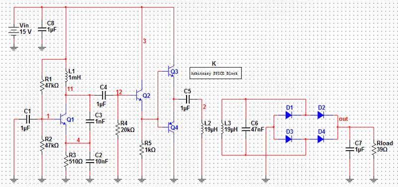

Hey guys, I've been building a circuit for a wireless cell phone charger. It's nearly completed but I don't know how to stop the circuit from drawing any power from its source when the phone is not 'connected'. It actually draws more power when it's not. How do I go about creating a circuit to fix this?
EDIT: Not vampire power. I need to know how to reduce no load power.

Oh, here's a circuit schematic attached.
*BTW, does the simulator account for effective resistance in a coil?

What is your frequency of oscillation and how much is your charging current?
You are running open loop, with a set pulse width. You are pumping and pumping with a square wave with close to 50% duty cycle regardless of the load! The transformer or the transistor must be getting hot when nothing plug into it. You need a PWM with feedback so when you don't have a load, the pulse width becomes so low you don't draw power!
Look into Linear Technology site, they have small, cheap DC to DC converter IC that you can build a circuit from. They might not be 100% oscillation free, but for charging cell phone, don't worry about it.
BTW, You missed one very important thing, you need to reduce the current charging to protect the battery when it is full. I am not familiar with battery charging, someone here with experience can give you advice on this.
Frequency is 170 kHz and I'm charging at 100 - 200 mA
