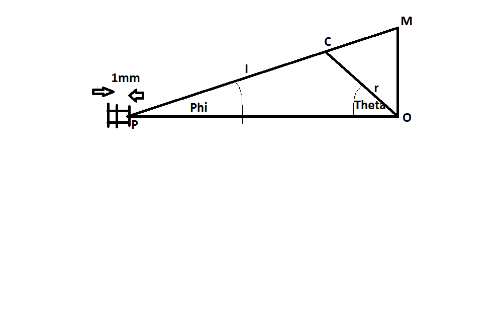

With reference to the Force Diagram, which represents a single piston cylinder rotating and producing 26NM of torque.
The technical data given is;
I = 70mm
r = 18mm
T = 26Nm
Theta = 17.13 degress
Phi = 4.34 degress
Using the diagram calculate the force on the piston Fp at 1mm before TDC.
Interestingly I can't solve this using the above data, but using trig in conjunction with the above I calculated the following angles;
Triangle OMC
M = 85.66 degress
O = 72.87 degrees
C = 21.47 degress
I worked it out like this;
PC = 18(sin 17.13) / (sin 4.34) = PM = I = 70.06 mm
The length (I) has now been proven.
Using the sine rule;
OM = 18(sin 21.47) / (sin 85.66) = 6.61
Force on piston Fp = 26 / 6.61 x 1000 = 3933 N
Once you follow it through you will see that I have not used much of the original data to solve the problem, but I am thinking there is an alternative method because I am to believe that the actual solution is
Fp = 3935 N
Although it is only two Newtons difference I could be using the wrong techniques?

Hi Casio, :)
How did you equate PC and PM?

Building on that, did you have your calculator set to use degrees and not radians?

Hi Sudharaka:)
Thanks for replying to the thread, I have worked out a full solution now to the problem, so will post it soon.
Kind regards
Casio
Hi Ackbach,
I didn't adjust the calculator to radians as the unit measurements were given in degress, but I have solved it and will post full solution soon.
Kind regards
Casio
Sorry for not replying earlier:D
I have worked on the problem and this is what I have now calculated.
With reference to the force diagram, which should be drawn as a rectangle to find the angles required.
The length of OM is;
OM = r 18(sin21.47) / (sin 85.66) = 6.6072mm
The length of "I" is calculated as;
I = PC = 18(sin 17.13) / (sin 4.34) = 70.0594 mm
The length OP is calculated as;
OP = Sqrt PC^2 - OM^2 = 70.0594^2 - 6.6072^2 = Sqrt 4856 = 69.69mm
Length of OP = OC + OP = 18 + 69.69 = 87.69mm
Force Fp = (r x F x sin(158.53))
Fp = T / r (sin 158.53) = 26 / 6.5883 = 26K / 6.5883 = 3946.4N
The compoent force acting on the piston is calculated from;
Fc = cos 4.34 = (3946.4 x cos (4.34)) = 3935.1N
