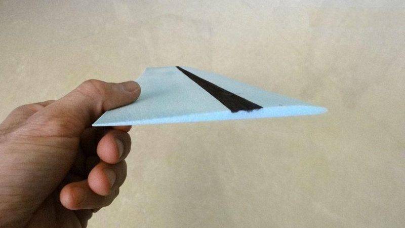

  • #56
scale factor
I was making a reference to small gliders similar to this one.
http://www.4p8.com/eric.brasseur/glider2.html
The article mentions that a lighter model flying at slower speeds would do better with larger wing chord and/or "flatter" wings due to Reynolds issues (slow speed, small wing chord). I'm wondering if there is much to gain in lift to drag ratio by using a more cambered airfoil for this type of model glider.
In the case of 1.5 meter gliders, thin but otherwise conventional air foils are used as seen in the attachment. The wings have full length ailerons that can be moved in unison to increase / decrease camber to provide a wider speed range. There are issues related to scale, speed range, and wing span being limited to 1.5 meters by the rules. The wings use a relatively large wing chord to increase wing area, which decreases wing loading and sink rate.

  • #57
The problem with using this site as a source is that, while he seems to have made a pretty neat balsa glider, his grasp of aerodynamics is at best incomplete. Sure he uses the term Reynolds number a lot (in quotes!), but it is pretty clear to me that he doesn't know what it is.
There is one bit in his article that supports what I said though. He points out that for the same lift and span, a flat wing would have a larger chord and therefore will fly slower. This is an awkward way to phrase it, but it is true. Really what that means is that you need a larger surface area for a flat wing to generate the same lift as a cambered wing. This is because a flat wing is less efficient. Essentially, the lift to drag ratio is lower for the flat plate. That is what I have been saying.
All of which is in line with what I have been saying. Unless you go to an extremely tiny scale, an airfoil will outperform a flat plate at generating lift regardless of the size (assuming that neither is experiencing stall, of course). If you go small enough to change that, you are likely in the range where we are talking about insect wings, and I am not nearly as familiar with aerodynamics on such a small scale as that.
