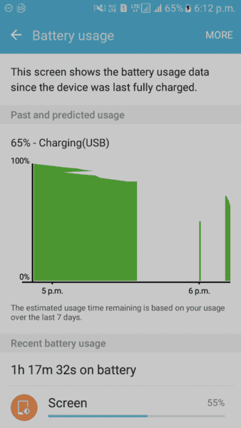

I am experiencing weird problems with my phone. It is a Samsung Galaxy On7, running Android 6.0.1, updated to the latest version, unrooted.
Since some days, the battery is falling very fast. For example, if I charge my device to 100%, open chrome and start writing this thread, at the end, it will go down to 60%. And the worst fact is, it just switches off.
Previously, I have used my phone even at 20% battery. Now, I cannot keep it switched on at 60%.
Today, I charged it to 94%, and switched it off. Then I took out the battery, waited for some time, and again put it in. It showed 2% charge was left. I again took the battery out, reinserted it, and found a charge of 75%.
Does this seem to be the problem of phone hardware, OS or battery? Maybe the hardware parts reading charge from battery have become faulty. I have the option to take it to a service centre, but since I cannot go at this moment, I am trying out software trucks to help me.
Any ideas?

I have seen that, and I have got the most unrealistic graphs in lifetime. One graph goes like this:
As per the app usage, all charge is being taken up be the screen. Previously, this was not the case. The screen brightness and timeout are the same as before. But I don't know how a dark screen can take up charge.

It's a long time since the last message was posted, but I felt it's my duty to write what happened to the phone finally. I went to the service centre. They examined it, and informed me that both the motherboard and the battery had to be changed. Got a bill of around 56 USD.
Also, they told me not to install too many apps, because that reduces the motherboard life. That can happen? Maybe. I did install and uninstall quite a number of apps since I had bought the phone. Never heard that it affects the motherboard.
