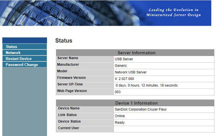

I feel for you. I had several gigabit quad-USB network servers, into which web-cams could be plugged for multiple view angles. Sorry, not compatible with Win'10...

Do you still have them? ##-## can you post regarding the manufacturer, model number, and other relevant specs? ##-## and also regarding the Win' 10 machine? ##-## it may be possible to reconfigure or mediate an incompatible device set to make it compatible ##\dots##
2-of Maplin N01JZ 4-port USB Gigabit Network server. *Perhaps* Yes, Elite Silicon Technology Inc © 2010.
Hunted from box-room, dusted and un-packed.
Small black box has power/lan/usb lights. 4@USB ports. Power switch, tiny reset hole, DC 9V inlet and 10/100 port. 'Wall-wart' and mini-CD.
No version or serial apparent. Purchased mid-2011.
The driver disk info covers both an HD PC to TV & Network server (!) and USB network server, but no images are given for the device itself. USB's manual refers to a uNet E-2800 Serial Multiple Function Printer Server Controller using EST 'UNTP' proprietary 'USB over LAN' protocol.
So, I've just connected to spare router port, run IP scanner...
Ha ! That's new !
HP647566 192.168.0.2 Neostar Technology Co Ltd 00:24:32:01:FC:A5
Chrome browser opened...
Manufacturer: Generic Firmware V.2.027.000
Then I put my nearest 'disposable' thumb-drive into port and hit 'Restart Device'. It found the drive, but offered no access. Win'10 x64 Device Manager could not find anything like a networked USB Server. Upside, I know the widget isn't a total brick. Downside, unlike the version in the 'manual', there's no provision for firmware updates.
