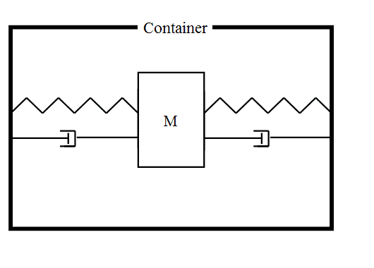

I've thought about this situation some more, and I'm afraid I'm going to have to take back what I said in posts running from #12 to #20. Your questions about gradual acceleration and deceleration prompted me to think more deeply into this problem, particularly post #19, and allowed me to gain better perspective.
Here's what I arrived at.
If I very gradually decelerate the container with gas in it, then the gas will not be deforming rapidly and viscous effects will be negligible. The container will exert a greater force on the leading edge of the gas than on the trailing edge, and the net work of these forces will result in the decrease in kinetic energy. There will be no dissipation of mechanical energy, and the internal energy of the gas will not change. It will be the same as if the gas were a rigid body.
Now, if I decelerate the container more rapidly, the kinetic energy change will be the same, but I will have to do more net work on the gas because of the viscous stresses that are now becoming more important. So, there will be an increase in the internal energy of the gas equal to the additional work needed to overcome viscous stresses (which is basically equal to the new larger net amount of work minus the change in kinetic energy). During the deceleration, the net force on the gas will be larger, but the distance will be smaller. However, the larger force will win out, and the new amount of work will exceed the integral of the force times distance present in the gradual acceleration case. Also, in this more rapid deceleration case, if the the deceleration only increases modestly, the change in internal energy will still be relatively small, and not anything near that approaching the change in kinetic energy. Without doing a detailed gas dynamics analysis of the gas in the container, it would not be possible to quantify the increase in internal energy.
Finally, if we go to the limit of a very rapid deceleration (virtually instantaneous), the same situation would prevail, but to a greater extreme. The net amount of work to stop the gas would be even higher because of viscous stresses. The net work would be higher than the change in kinetic energy, but by an unknown amount. And this unknown amount would determine the increase in internal energy. So, in a very rapid stop, the increase in internal energy is not going to be equal to the change in kinetic energy. It will probably be less.
For the case of very gradual acceleration, we will have the analogous situation. The net work will be virtually equal to the increase in kinetic energy, and the change in internal energy will be essentially zero. Then, as we go to a more rapid acceleration, we will have to do more work to overcome viscous stresses, but the increase in internal energy will be determined by the net work minus the increase in kinetic energy. This quantity would be unknown without a gas dynamics analysis. Finally, at very rapid (virtually instantaneous) acceleration, we would experience the same situation. The net work would be still higher than the change in kinetic energy, and the internal energy would increase.
The reason I was driven to these conclusions was that, if one applies the same approach to the acceleration that we had previously used for the deceleration, we would determine that, for an instantaneous acceleration, since the kinetic energy increases, the internal energy must decrease. This of course does not make any sense. The internal energy must increase in both cases because of viscous dissipation.
Sorry for any confusion I may have caused.

FOR DECELERATION
$$\Delta U + \Delta (KE)=-W$$where W is the positive work that the gas does on its surroundings (the container) and ##\Delta (KE)## is the change in kinetic energy (negative). So,
$$\Delta U=-(\Delta (KE)+W)\geq0$$with the = sign applying to very gradual deceleration and the ##\geq## sign applying to very rapid deceleration. Alternate and equivalently, $$W\leq-\Delta(KE)$$This equation says that, because of viscous dissipation of mechanical energy, the amount of work that the gas does on its surroundings (the container) is less than its decrease in kinetic energy. (Not all the kinetic energy can be converted to work).
FOR ACCELERATION
where, in this case, W is negative, since the surroundings are doing work on the system, and ##\Delta (KE)## is positive. So,
$$\Delta U=-(\Delta (KE)+W)\geq0$$with the = sign applying to very gradual acceleration and the ##\geq## sign applying to very rapid acceleration. Alternate and equivalently, $$-W\geq\Delta (KE)$$This equation says that, because of viscous dissipation of mechanical energy, the amount of work that the surroundings needs to do to accelerate the gas (-W) is greater than its increase in kinetic energy. (Additional work is required to increase the kinetic energy).
So we see that, both in rapid acceleration and rapid deceleration, the internal energy increases (actually, as we shall see shortly, by exactly the same amount). If we were to use the same rationale that we had used in the original analysis of the problem to determine the change in internal energy for acceleration, we would have written that ##\Delta U=-\Delta (KE)## and we would have concluded that, for acceleration (##\Delta (KE)>0##), ##\Delta U## is negative.
Actually, we will now show that for the same magnitude of the change in kinetic energy, the change in internal energy is exactly the same for extremely rapid acceleration as for extremely rapid deceleration. We know from Galileo that the laws of physics do not change when a system is observed from two different inertial frames of reference. So, consider deceleration as observed from the following two inertial frames of reference:
Frame 1. The laboratory frame that has already been used to analyze the deceleration problem (where the observer is stationary on the laboratory floor)
Frame 2. An inertial frame in which the observer is moving with the original velocity of the container (in the positive x direction) forever (relative to to the laboratory frame).
As reckoned by an observer in inertial frame 2, the container is standing still, and the barrier that is going to stop the motion of the container when it hits appears to be moving toward the container in the negative x direction with velocity v. Once the container hits the barrier, both the container and the barrier are moving with the velocity v in the negative x direction. So, as far as the observer in frame 2 is concerned, the container and gas start out standing still, and, after the barrier hits them, they are instantly accelerated in the negative x direction to a velocity of magnitude v. So, as reckoned from frame 2, the container has experienced an acceleration exactly equal to the deceleration reckoned by an observer in the laboratory frame (frame 1). This shows that the change in internal energy for the acceleration and deceleration situations must be exactly the same for the same magnitude of the change in kinetic energy. The two situations are indistinguishable physically (since neither inertial observer can prove that it is his frame that is stationary and it is the other frame that is moving).

Well we now know that this was not correct. Otherwise, it could not predict a different result for acceleration than for deceleration. You're the one who asked about acceleration, which led to this realization. You should be proud of yourself. I must admit that I was unaware of all this.
As I mentioned in post # 21, for some problems, one can not obtain the desired solution without analyzing the transient details of the flows and deformations occurring within the system. (Not every problem can be solved with equilibrium thermodynamics). To attack this problem, I would use gas dynamics to solve the problem for various imposed constant decelerations of the container from very low values to very large values. But it's not a simple problem.
