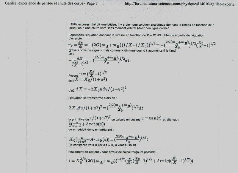

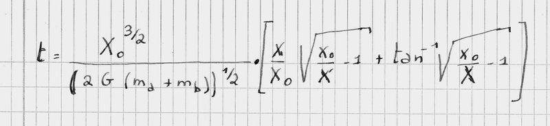

I have found on the net a solution of Newton equation. And I just want to have your view.
The speed between two mobiles moving towards each other is: (only with gravitation)
dx/dt = - square root (2.G.(m1+m2).(1/X0 -1/X))
Where X0 is the distance between the two mobiles when they are released without initial speed.
And X the distance where we measure the speed. (X0>X).
A solution is: (SR is square root)
t=SR (X0³/(2.G.(m1+m2))).(X/X0.SR(X0/X-1)+arctg(SR(X0/X-1)))
The author of the solution poses: u = SR(X0/X-1).
Thank you for your opinion.

I am presuming that the difference between the calculation from your numerical method and the result of the integral used in the formula in the link I provided is more significant that allowed for this numerical method. The way you wrote your formula is a little ambiguous: from your manner of writing it, I think you wrote
If this is wrong, please correct it. It would help if you showed your formulas upon which you are basing your calculations in a readable way, because if you are getting two different answers, then obviously something is wrong., then rather than make the calculations too tedious to follow, you can do one of three things:
(1) write them in Latex
(2) scan them and upload them using the "upload" button, or
(3) provide a link to the site where you got the formulas from. (Note: I am fluent in French, so there is no problem if you provide a link to a French website.) [However, please don't provide your calculations in a computer program, as I am less fluent in programming languages.]

Hello.
Oups. This is the rigth formule...
You can find here how the calculation is made
Thank you for your attention.
Lucw.
OK, back for a few minutes, so a quick observation: since
that is, the formula from http://forums.futura-sciences.com/physique/814010-galilee-experience-de-pensee-chute-corps-7.html matches the one from https://physics.stackexchange.com/q...-masses-will-collide-due-to-Newtonian-gravity (and https://www.physicsforums.com/threads/remarkably-difficult-Newtonian-problem.360987/#post-2497264 ) for the case when x=0, and since I don't see anything wrong with the derivation, I will make the leap of faith that the former formula is also valid for x≠0. But without going into calculations, my comments still hold that when the sum of the two masses is the same, the time will be the same, and when the sum is varied to an insignificant amount (e.g., apple versus cannonball on the earth), the time will vary also only by an insignificant amount (especially if one is doing numerical integration), but when the sum changes significantly, then the time will correspondingly change significantly. What I find odd in the French forum is that one comment was about proving both Galileo and Aristotle right, whereas they are two opposing positions. To quote from Wikipedia, "Galileo supposedly discovered that the objects fell with the same acceleration, proving his prediction true, while at the same time disproving Aristotle's theory of gravity (which states that objects fall at speed proportional to their mass)." https://en.wikipedia.org/wiki/History_of_gravitational_theory (or, if you prefer, https://fr.wikipedia.org/wiki/Histoire_de_la_gravitation)
Hello Nomadreid.
Thank you for your answer.
We have an equation ...
First remark.
If we set X0, X and mb. And if we increase m, the duration decreases. Aristotle is therefore right. The heavy ones fall faster ...
Second remark.
If we set X0, X and the sum (ma + mb). And if we increase ma (mb decreases ...) the duration is the same. And Galileo is right. All bodies fall in the same way.
This is not the first time I have tackled this problem. But I still see this same "human" resistance. To changes.
Think of the initial acceleration of the masses in both configurations; the distance traveled by the mass a in both configurations. It's the magic of Newton's laws ...
Lucw
