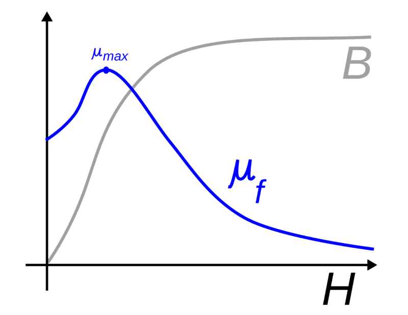

I believe that if a put current through a coil of wire and if I have unlimited power to force through that current and if the coil can accept unlimited power without being degraded, I could produce a magnetic field in a vacuum of unlimited strength-is that correct? But supposedly if I applied such a magnetic field to a permeable material, there will come a point where applying stronger and stronger magnetic fields from the coil will no longer increase the magnitude of the magnetic field inside that material and that is called saturation. Therefore, if I understand this correctly (do I?), the presence of a permeable material somehow limits the maximum magnitude of a magnetic field that can exist inside it due to saturation-is that true? If it is true, please explain to me how the presence of a permeable material can possibly reduce magnetic field strength from what it would have been in a vacuum? What mechanism does that? Would it be true that if I want to have the strongest possible magnetic field, I should avoid using a permeable material since using such material limits the maximum magnetic field strength?
Yes, this is true in principle.
No, that's not true. From https://en.wikipedia.org/wiki/Saturation_(magnetic):
The relation between the magnetizing field H and the magnetic field B can also be expressed as the magnetic permeability: 𝜇=𝐵/𝐻 or the relative permeability 𝜇𝑟=𝜇/𝜇0, where 𝜇0 is the vacuum permeability. The permeability of ferromagnetic materials is not constant, but depends on H. In saturable materials the relative permeability increases with H to a maximum, then as it approaches saturation inverts and decreases toward one.
Due to saturation, the magnetic permeability μf of a ferromagnetic substance reaches a maximum and then declines:
Since the relative permeability of vacuum is one, this means that for large enough fields ##H##, the ferromagnetic material behaves magnetically more and more like vacuum. So ##H## can in principle be increased without bound even inside of a saturable material.
