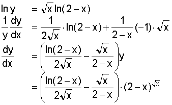

Something about this worked problem looks off. Is this example correctly solved using logarithmic differentiation?
The original problem is y = (2-x)^(sqrt x). If anyone who is rather confident with this could double check this example it would really help me out. Thanks. I attached the link to reduce my typing confusion.

Here's the image:
What is it that looks off to you?

I can not pinpoint anything. I am aware of the steps of the log diff for other examples on this weeks homework. Prof through it out to the class that this looks off. I can't see it. Should I look deeper?
Looks perfectly fine to me.
Provided you understand the product rule, the chain rule, and the fact that ln(a^b) = b.ln(a), there isn't really anything mysterious here at all.
ok thanks. Perhaps it was thrown out to check our grasp of your aforementioned rules. Thanks for the time.

y = (2-x)^sqrt(x)
And you want the derivative?
yes, using logarithmic differentiation solve the problem.
In general, when you have something like [tex]f(x)^{g(x)}[/tex] you can find the derivative like this, which should give you what you need to solve your specific problem where log is the natural logarithm:
[tex]y=f(x)^{g(x)}[/tex]
[tex]\log{y}=g(x)\log{f(x)}[/tex]
Implicitly differentiate both sides:
[tex]\frac{dy}{y}=g'(x)\log{f(x)}dx+\frac{g(x)f'(x)}{f(x)}dx[/tex]
[tex]y'=y\left(g'(x)\log{f(x)}+\frac{g(x)f'(x)}{f(x)} \right)[/tex]
[tex]y'=f(x)^{g(x)}\left(g'(x)\log{f(x)}+\frac{g(x)f'(x)}{f(x)}\right)[/tex]

It looks fine.

What exactly do you mean by "some pushback"? Has your Prof said something? If so, what? Is he/she worried about the domain/range not being real etc?
Even the God Almighty that is Woolfy-Alfa agrees that this is the correct solution.
