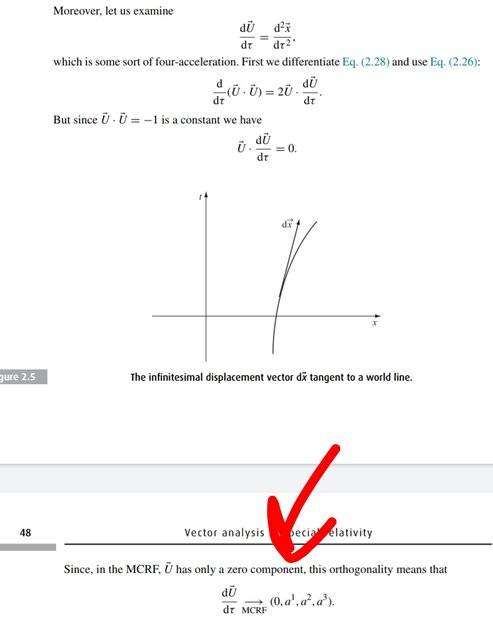

Is this just a typo in Schutz' book on General Relativity?

I'm wondering is I'm missing something, or this should be " a non-zero component"?
The book is correct. In the momentarily comoving inertial frame the time component of the four-acceleration is indeed 0.
No, it means that in the MCRF the only non-zero component of ##\tilde{U}## is the zeroth one (because the three velocity is zero by definition in that frame). Hence the four acceleration (which he's just proved is orthogonal to ##\tilde{U}##) must take the form given.
I agree it's not particularly clearly written - it would be better if he'd said "##\tilde{U}## has only a ##{\tilde{U}}^0## component".
Ah yes, it's clear now. I thought he meant that it had only one component taking the value zero, which didn't make sense.
I must say this isn't the only thing I've found confusing in Schutz. The physics is sound enough, but I do feel like he really needed a better editor.
