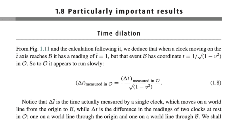

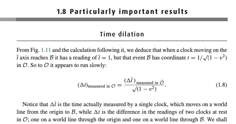

I have been enjoying learning relativity from the book "A First Course on General Relativity". I came across a somewhat confusing experiment mentioned in Chapter 1.8, which I have attached here:
Namely, I am referring to how you might measure ##t=0## as "the difference in readings of two clocks at rest on ##\mathcal{O}##." I can't understand how such an experiment would be done, for I would think that the difference between two clocks, one at the origin and one at the spatial position of event B with worldlines parallel to ##t##, is zero, if both are allowed to run until event B.
Should I instead understand this as the difference between the readings of two clocks, one which is positioned at t = 0, and another which is positioned at ##t = B##?
But, the "proper time" is also the difference between times of two clocks. It's the difference between "two clocks, one at the origin, and one which passes through event B".
I'm not sure what I am missing from the statements made in the passages I have enclosed. Thanks very much for your help.
It doesn't say ##t## is the difference in readings of two clocks. It says ##\Delta t## is. They're not the same thing.
The difference ##\Delta t## is the difference between the reading of the clock at the origin, when the moving clock passes it, and the reading of the clock at ##\mathcal{B}##, when the clock passes it. So you're only looking at the clock at ##\mathcal{B}## at event B. You're not looking at the clock at the origin at the same time in frame ##\mathcal{O}## as event B.
You can't position a clock at a time. What determines the events at which you take the readings of the two clocks at rest, is when the moving clock passes them, i.e., at the intersections of the worldlines.
No, it isn't. It's the difference in readings of a single clock, the moving one, between the same two events--the event where its worldline crosses the worldline of the origin clock, and the event where its worldline crosses the worldline of the ##\mathcal{B}## clock.

I see, thanks so much @PeterDonis! I was confused on several points, such as the difference between events and readings of clocks. I think I misunderstood what Schutz was saying in this case. Maybe what is meant, more verbosely, is that "the difference in readings of two clocks in frame ##\mathcal{O}##, one which passes through the origin and one which passes through the spatial components of event ##\mathcal{B}##, the first of which is measured at ##t = 0##, and the second of which is measured at the occurrence of event ##\mathcal{B}##, is equal to ##\Delta t##."
Is this more accurate (and more wordy, I presume)?
Yes, this is what Schutz was describing.

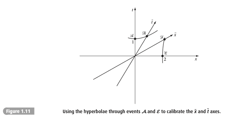

The point to note that is that ##\Delta \bar t## is the unambiguous proper time measured on a clock between two events (points) on its worldline. Whereas, ##\Delta t## is the coordinate time (between those two events) measured in some inertial reference frame in which the first clock is not at rest. How you measure the coordinate time is, of course, a matter that requires some thought. (In his original 1905 paper, Einstein goes into this in considerable detail!)
You could have two clocks at rest at the points in space where events squiggly A and squiggly B take place, and have a simultaneity convention for those two clocks. This is the usual theoretical assumption, using the default Einstein simultaneity convention.
Or, you could have a single clock at the origin and a light signal sent to the origin when event squiggly B takes place. When the signal arrives at the origin, you have to subtract the light signal travel time to get the coordinate time of event squiggly B. This is, of course, equivalent to the Einstein simultaneity convention. This is the usual practical situation observing cosmological events - as we cannot go out into space and place synchronised clocks wherever we need them. We can only make direct observations of distant observations here on Earth.
