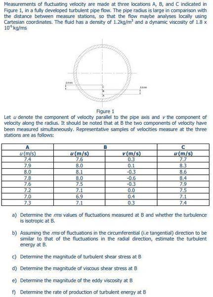

Chet, here is the full picture of the problem.
Question a asks me to calculate rms values of fluctuations at B and whether it is isotropic, to which I answer (with your help, thank you very much):
First rms fluctuations= 7.55
Second rms fluctuations= 0.3352
There are two different rms values of fluctuations at B (one parallel to the pipe axis and another one along the radius) and thus the turbulence is not isotropic at B.
Now Question B asks me to calculate the turbulent energy at B, with rms of fluctuations in the circumferential = rms fluctuations in the radial direction.
Which why I thought that the rms values I have calculated could be used in the kinetic energy calculation.
Would you mind explain to me why it is not the rms fluctuations I have calculated (7.55 and 0.3352) before?
Thank you for your patience & continuous guidance, sir!
These are not the rms fluctuations. There are the rms velocities. To get the rms fluctuations, you first calculate the time-averaged velocity, then you subtract that from the instantaneous velocities to get the velocity fluctuations, and then you evaluate the rms value of the velocity fluctuations. Didn't you learn this from your textbook or in class? Now please, go back and report back to me with the time-averaged velocities and the correct rms values of the fluctuations for part B.
Chet

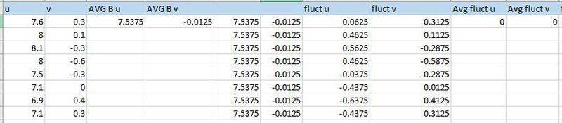

Thank you for clearing that up Chet! Unfortunately I don't have a textbook or lecture slides on this, but I have borrowed some books from the library.
I learned that:
U(x,t) =U (x,t) + u(x,t)
Where U is the velocity, U is the time averaged velocity, u is the fluctuations.

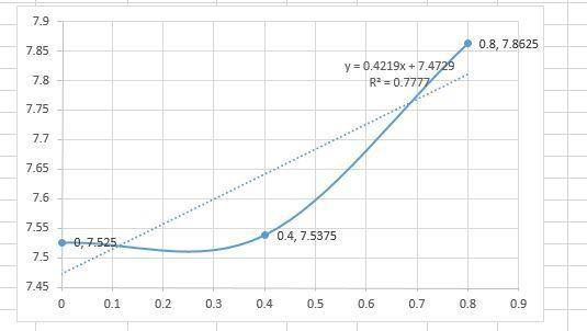

I read that:
U
(x,t) = ½T ∫ U(x,t +t') dt'
But I'm not quite sure on how much T I should take (although I read that it has to be significantly large), and I don't really know how to solve that (with t' and dt'), so I decided on taking another method.
Here I calculate the average of the velocity u (axial) and v (radial), and obtained 7.5375 and -0.0125.
I take this as the time-averaged velocity.
And thus I calculate the fluctuations.
The first fluctuations:
u(x,t) = 7.6 - 7.5375
u(x,t) = 0.0625
Did the same to the rest.
Finally I calculate that the rms fluctuation values for axial direction and radial direction and obtained 0.43857 and 0.33307. The flow is thus not isotropic at B.I also read that the turbulence kinetic energy equals to
k = ½ (u'2+v'2+w'2)
I have obtained the fluctuations u and v (Assuming that my rms fluctuations are correct) and w=v= 0.33307 then the turbulence kinetic energy=
k = 0.5 * (0.438572+0.333072+0.333072)
Am I heading in the right direction? Thank you, Sir.
u(x,t) = 0.0625
k = ½ (u'2+v'2+w'2)

Chet, would it be alright if I ask you about the subsequent questions? I'm worried that I might be making mistakes, like the ones I did with the fluctuations.
The next question asks me to calculate the magnitude of shear stress at B, and I read from a book that the total stress for turbulent flow is:
τ = ρv(dU/dx) - ρu'v' (I did not consider the isotropic stress)

Thank you, Sir. I found that the average fluctuations u' and v' are both zero. Thus the shear stress is zero.
τ = -ρu'v'
τ = -1.2 * 0 * 0
τ = 0
Will this be acceptable?

I found the average velocities at A, B and C respectively are:
A= 7.525
B= 7.5375
C =7.8625
I was thinking that the derivative of the average velocity may be obtained if I plot them on a chart, taking the gradient from the equation?
Thus the derivative of the average velocity is 0.4219?
Thank you very much for your help.
No. I said the "average of the products," not the "product of the averages."
A= 7.525
B= 7.5375
C =7.8625
I don't know how you got that average velocity plot, but it doesn't look right. How did you end up with the funny shape?
For the velocity gradient, I get: (7.8625 - 7.525)/0.8

I tried searching about the difference between the 'average of products' and the 'product of averages'. But I still don't quite get it yet. Do you mean I should reduce the each velocity components with each other and find the fluctuations?
At B:
u' =u1 - u2 = 7.6 - 8 = -0.4
u' =u2 - u3 = 8 - 8.1 = -0.1
u' =u3 - u4 = 8.1 - 8 = 0.1
u' =u4 - u5 = 8 - 7.5 = 0.5
u' =u5 - u6 = 7.5 - 7.1 = 0.4
u' =u6 - u7 = 7.1 - 6.9 = 0.2
u' =u7 - u8 = 6.9 - 7.1 = -0.2
Average u' = (-0.4-0.1+0.1+0.5+0.4+0.2-0.2)/7 or 7.6 - 7.1/7
Average u' = 0.07143
v' =v1 - v2 = 0.3 - 0.1 = 0.2
v' =v2 - v3 = 0.1 + 0.3 = 0.4
v' =v3 - v4 = -0.3 + 0.6 = 0.3
v' =v4 - v5 = -0.6 + 0.3 =-0.3
v' =v5 - v6 = -0.3 - 0 = -0.3
v' =v6 - v7 = 0.0 - 0.4 = -0.4
v' =v7 - v8 = 0.4 - 0.3 = 0.1
Average v' = (0.2+0.4+0.3-0.3-0.3-0.4+0.1)/7 or 0.3 - 0.3/7
Average v' = 0
And thus
τ = -ρu'v'
τ = -ρ* 0.07143 *0
Is this correct?
Thank you kind Sir.
