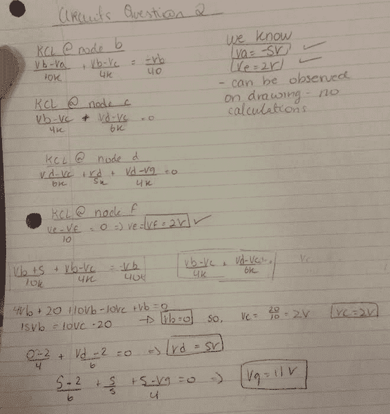

I am wondering if in this circuit Vb will be 0V?
I have found all the other ones, but I am unsure if Vb will be 0 or not, and if it is then what is the logic behind it?
If you've found all the others then you must know the voltage at node c. That means you have everything you need to do nodal analysis for node b.

Not quite, I am given the answers for each node and asked to prove that they are right, all of my proof uses the fact that Vb=0, but I don't know how to prove that

Then you need to analyze the circuit, starting by using the properties of the ideal op-amp. Start by finding the potential at its + input (node f).

I wrote all the equations for nodes b, c, d and f. Since we can see that Va=-5V and Ve=2v, from the drawing. I just end up with 3 eqns and 4 unknowns

You'll have to show the details if you want help.
You should be able to determine the potential at node f by inspection.

Handwritten circuit analysis on lined paper: KCL equations at nodes b, c, d and f with resistor values 10k, 4k, 6k and 5k, a note that Va = -5V and Vc = 2V, and results Vb = 0, Vc = 2V, Vd = 5V and Vg = 11V.
But here I take the assumption that Vb=0, I want to know if that is logical or if it would not be 0V
You know the potential at f, so using the properties of the op-amp what must be the potential at its "-" input?

Ok so potential at f and c have to be the same ?

Yes. So long as an op-amp circuit provides a negative feedback path, it must be so.
