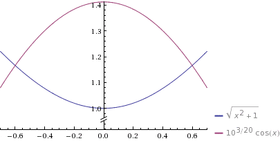

I missed this earlier, but... I'm not sure what you mean with that equality. It's not true as stated (see graph):

SammyS said:
Actually, that equality is true !
It leads to \displaystyle \sqrt{x^2+1}=10^{3/20}\cos(x)\ .
man, trig makes my head hurt...
I don't get it. I'd drop it, but my sense is that this is part of the problem that Tyrone is having too (maybe I'm wrong, but...).
I know that graphs don't prove anything, but the graphs are (extremely) different (even with the cos(x) product added to the one side), so... I'm confused.
Here are the graphs of y=\sqrt{x^2+1} and y=10^{3/20}\cos(x) overlaid on the same graph (from WolframAlpha).
What is graphed here?
Take Tyrone's original equation.
\displaystyle 20\,\log_{10}\left(\frac{\sqrt{x^2 +1}}{\cos(x)}\right)=3\​
Do a little basic algebra & apply some of the log rules you suggested:
\displaystyle \log(\sqrt{x^2+1})-\log(\cos(x))=\frac{3}{20}
\displaystyle \log(\sqrt{x^2+1})=\frac{3}{20}+\log(\cos(x))
If you use each side as the exponent with a base of 10, you get:
\displaystyle \sqrt{x^2+1}=10^{3/20}\cos(x)\​
