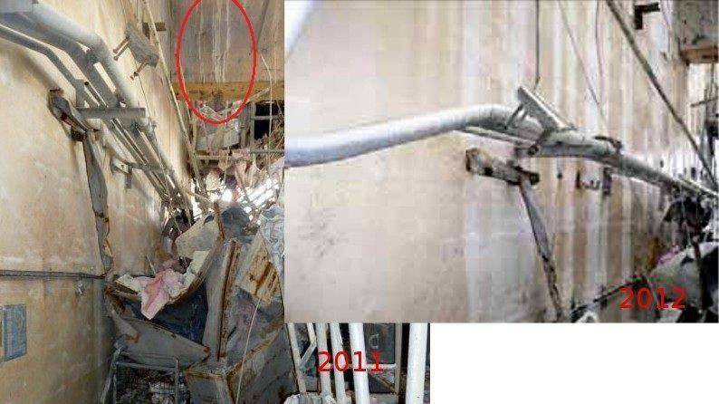

HowlerMonkey said:
The white stuff may be the salt left behind by the many thousands of gallons of seawater that were sprayed willy nilly about the place.
I suppose it could be salt. Also it might be an effect of general soluble mineral transport by incoming rainwater; the cracked wall section is facing west and the ceiling above it has been blown away, so it is actually quite exposed to the weather.
Sands used for construction is usually washed in water before usage to avoid soluble and organic contents.
So it is cement salts and/or seawater salts.
Quantity indicates deep concrete cracks.

MadderDoc said:
Yeah, right. And they downsampled the photo such as to not confuse people with minor details. Saltwater in my eyes.
Speaking of details, what would be the nature of the white stains running down that part of the wall below the crack above them in the photo from the 2012 announcement? There are no stains visible in the 2011 photo of the same spot:[/PLAIN]
There are stains on the 2011 photo:
https://www.physicsforums.com/attachment.php?attachmentid=48104&stc=1&d=1339053367
I think it's not salt. As I know the top level of U4 were not 'sprayed': even the first attempts to fill the pool were more or less accurate (with the concrete pump).
What about mud/dust (carried by rainwater)?
Check the pipe in the right-bottom corner:
http://cryptome.org/2012-info/daiichi-12-0526/pict6.jpg
Top of the equipment racks on the right:
http://cryptome.org/2012-info/daiichi-12-0526/pict8.jpg
Top of the machinery (2TON) on the right:
http://cryptome.org/2012-info/daiichi-12-0526/pict7.jpg
COncrete walkway on the right:
http://cryptome.org/2012-info/daiichi-12-0526/pict16.jpg

Rive said:
Yes, but I'd say, they are not as pronounced and in as many paths. This may have been a progressively developing thing.
I also lean to later events or processes. While I can't exclude that there has been some spraying, I don't think it has caused these stains, they look too much to me as stains produced by water -- the way they channel around obstrúctions on the wall. Generally I think there is much greyness and deposits from concrete dust in the building. Rainwater is perfectly capable of dissolving substances from fresh concrete dust and reprecipitate a whitish deposit in runners down a wall. Alternatively, there might be a superficial yellowish discoloration of the wall produced by the heat of the explosion, which water can wash away.
There are some distinct splotches of white on some of the equipment in this photo which was clearly not there earlier, and which may well be from spraying. However generally the greyness seen I'd assign to a combination photo artefact and concrete dust.

They spraying I sometimes mention was of anti-scatter/dust suppressant material. I can't find proof right now that they did this for reactor 4, but there are TEPCO videos which show this activity being carried out at other buildings using the cream rather than green substance. It was done late May/early June 2011, here for example is the webcam video of them doing it to reactor 1, the action starts after about 3 minutes of the video. http://www.youtube.com/watch?v=ntjOm7x-KaY&lr=1
Other possibilities seem equally plausible, or some combination, e.g. the anti-scatter agent is eventually partially washed away by rain, or by occasions where they may have overfilled the pool (seem to remember an issue with this happening at some point after they switched to a better way to cool the pool, but could be a false memory).

SteveElbows said:
They spraying I sometimes mention was of anti-scatter/dust suppressant material. I can't find proof right now that they did this for reactor 4, but there are TEPCO videos which show this activity being carried out at other buildings using the cream rather than green substance. It was done late May/early June 2011<..>
Probably it would have been some time between June 6th:
http://photo.tepco.co.jp/en/date/2011/201106-e/110611-03e.html
and June 30th:
http://photo.tepco.co.jp/en/date/2011/201106-e/110630-04e.html
The spraying may have been repeated later. I see strong indication of recent spraying with dust inhibitor somewhere near the valve area shown in the photo from July, at http://photo.tepco.co.jp/en/date/2011/201107-e/110706-02e.html.
