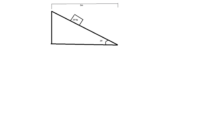

Starting from rest 10.0 kg mass slides 5.00 m down a 20.0 incline. The coefficient of kinetic friction is 0.300. (a) Determine the work done by the force of gravity. (b) Determine the work done by the force of kinetic friction. (c) Determine the change in gravitational potential energy. (d) Determine the kinetic energy of the block at the bottom.
umm...
kinetic energy = 1/2mv² i believe
gravitational potential energy = mass*gravity*height
Work = Force * distance * cosθ
well for part A) I was thinking
(10.0kg*9.81m/s²) * 5.00m * cos(20)
for part B) I was thinking
.300 * 5.00m * cos(20)
for part C) I was thinking
10.0kg * 9.81m/s² * (5.00m *sin20)to find the vertical height??
and for part D) I was thinking it would be 0 because at the bottom...velocity would be 0...so 1/2*mass*0² = 0
are any of these assumptions correct?
Be careful with the angle at (a).
At b: You need the force of friction first. This is not the same as the coefficient of friction (which you can see from the mismatching units, for example).
Why do you think the velocity is 0 at the bottom?

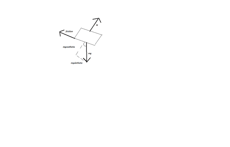

why won't the angle be 20 degrees in part (a)? It's not a straight down plummet...but is the fact that gravity acts straight down an indicator that the angle sould be 0 degrees?
and ohh okay So I'd have to solve the kinetic friction = μ_k * N first for part (b)
and I was thinking that the velocity would be 0 at the bottom because it doesn't specify where at the bottom...but just the bottom...so i figured that the kinetic (moving) energy would be the 1/2*10.0kg * velocity at the bottom, which I thought would be 0...but I suppose I am wrong?
For part (a) would I use *sin* instead of *cos* in the Work equation? since the block is moving in the same direction that mgsinθ is pointed in?
for (b)... we solve for friction
friction = μ_k * N
from the FBD...N = mgcosθ
so that work equation would look like
W = (.300 * mgcosθ) * 5.00m * cos(20)
is that correct? because that is the only "work" equation I see on my sheet

Good move. The component of gravity in the direction of the ramp is mgsin(20).
friction = μ_k * N
Wy the cos(20) term at the end? Your force is 0.3mgcos(θ) and your distance is 5m. End of story.

Look, the force between the block and the ramp is mg cosθ. So the force of kinetic friction is that times the kinetic friction coefficient. And the distance is 5m. Like I said, end of story. Work = force times displacement.
CollegeStudent said:
great! alright...And if my last statement is correct...the the fact that the force here is mgsin theta which creates a 90° angle with the displacement...then the cos would be of 90°...which would = 0
So then wouldn't the work done by the force of gravity = 0?
No, gravity work = force of gravity along the ramp times ramp distance.
ohhh...
so then
mgsinθ * 5.00m
(NO cosθ at the end because it was already used! Again THANK YOU for pointing this out!)

It actually is but you should think as follows:
potential energy loss = mgh where h = 5*sinθ in this case
friction energy lost = 5*0.3*mgcosθ
therefore kinetic energy gained = potential energy lost - friction energy loss
Take note that "p.e. lost" and "friction loss" are both positive numbers the way I've defined them.
In other words, you've lost p.e. so you should have gained that much k.e. but some of the k.e. is discounted due to friction loss along the way.
(Like in money: you lose $100, you don't lose -$100. Etc.)
