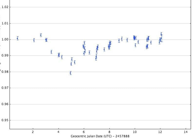

If it is something that breaks apart the structure could get more complex each orbit. We'll see the what happens this time over the next few weeks, and then get more data mid 2019 (in the worst case we don't get any dips, but that would help ruling out models as well).
In the graph for the first dimming event, the baseline fluctuation seems to have disappeared completely for the 12 day period. Even the measurement error of about 0.0025 (inferred from the recently posted graph for the current dimming event) isn't apparent in the data. That makes me suspicious of either the data or how it is being represented.
Looking at the curve for the second dimming event, we can see that the graph seems to use a curve interpolation. I wonder how many data points actually contribute to that first curve. A small number over the 12 day period would explain a lot.
Alternatively, if there a large number of data points and the measurement error from the data for the current dimming event is relevant for the first dimming event, then we must ask how those measurements became correlated.
Note the different scales on both axes.
If you scale the noise seen in the large plot to the short period in time but the large range in y, you don't see it any more.
Both curves are probably smoothed (typical raw 15 minute measurements have significantly more noise), but on a scale of an hour or so, not on the scale of days.
