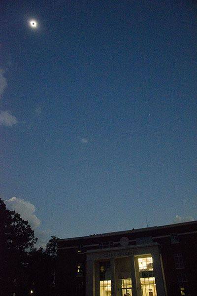

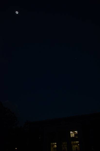

No, it's from my Nikon D7000 DSLR. I had to adjust the brightness levels very strongly in Photoshop, using the RAW file from the camera. Here's the JPEG that the camera saved at the same time, unmodified except for image size.

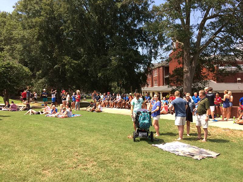

I took some pics with my iPhone 5S, of the crowd (not the sun itself) as totality approached. The phone's autoexposure boosted the overall brightness so much that at first glance they might have been taken during full sunlight. However, the colors and shading are somewhat unnatural. The concrete sidewalk has a definite yellowish cast which is not normal.
I think @jtbell took an excellent picture (pre-Photoshop), and it should be made clear that that is an absolute upper limit on what can be expected.
As far as colors and shading beingunnatural, the world looks (to the eye) very blueish. I believe taht is because we are used to seeing this level of light at dawn and disk, when the illumination is quite red, and we have subconsiously learned to compensate.
