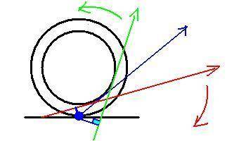

Here example from Schaum series, 3000 problem in physics
If the origin for calculating torques is taken at P, point of contact between spool and the tabletop, the torques due to gravity, friction, and the normal force are all zero.
The force colored blue the torque about P is zero. The spool will not rotate if pulled gently and does not slip. It must be that the spool remain motionless
From the configuration,
Cosθ=r/R
Cosθ=r/R
Both the linear and angular accelerations are zero at angle θc. It does not mean that the spool is motionless.
I tried out the spool experiment too, it only skids at that particular angle, without rolling, as ehild says. But that is only considering that we pull it hard enough. Azizlwl's example involves a gentle force, hence the motionless spool. Considering we can pull it quite hard, it will not have any particular angle where it can stay motionless, and has to skid. But skidding at this point or not(zero linear acceleration being the limiting case), this is that exact angle where applied force will never cause a rotational acceleration, and it is what is asked in the problem.
ehild said:
What about fs when the spool rolls backwards (T is positive, a is negative)?
It really shouldn't matter. 'a' is the variable here, it can be negative too, so it includes that case. As for a limiting case, 'a' would be 0, which is considered in the question.
Try an other way to solve for other angles when pulled with a certain force T assuming the spool does not perform pure rolling, but it both skids and rotates. There is a limit for the angle when pure rolling changes to skidding and rolling: at that angle when the tension is not enough to overcome the maximum static friction.
I made an assumption that the friction is sufficiently enough, as with most rotational motion problems. I'll try it without that assumption too.
Imagine a frictionless surface. How will the spool move if pulled?
ehild
Non-roll skidding at the critical value, and -never- zero linear acceleration :biggrin:
