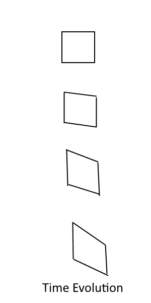

A little more on this point that the congruences @PeterDonis and I have been using do, indeed, have constant horizontal velocity when transformed to the hole frame. In the calculation indicated above, I simply Lorentz transformed the equation of a congruence world line. However, it is readily shown that the same results from transforming a 4-velocity.
Consider a 4 velocity in the rod frame given by: ##\gamma (v) (1,0,v)## with coordinate order (t,x,z). Now boost of u in the x direction gives: ##\gamma(u) \gamma(v) (1,u,v/\gamma(u))##. A key thing to note is that from a general formula for composition of ##\gamma## : ##\gamma_{res} = \gamma(u) \gamma(v) (1-uv \cos(\theta))##, for the case of u and v orthogonal, we just have ##\gamma(u) \gamma(v)##. Thus the transformed 4-velocity in terms of total ##\gamma## of the particle in the boosted frame is just: ##\gamma (1,u,v/\gamma(u))##, meaning that coordinate x velocity is simply constant u in this frame, as I have claimed. This is also exactly the same as I got transforming the equation of a congruence world line.
Yes, after working through the transformation myself, I agree with this. I think the issue I referred to before that came up in the previous "sliding block" threads was looking at the ordinary velocity in the ##x## direction in the MCIF of the chosen piece of the rod, not in the original rod rest frame.
A further follow-up: I realized on reviewing the general equations for kinematic decomposition that the extra step of projecting with the tensor ##h## is not needed. I have edited post #54 accordingly, and have deleted what was the post just after it that contained the projections. The final tensor whose components are given in post #54 is the one that I called ##K_{ab}## before, i.e., the one that gets split into the three pieces of expansion, shear, and vorticity. That makes things look somewhat neater.

Just a quick comment on why shear and/or expansion must be expected for this case. Given that everyone agrees that for a rod horizontal in hole frame starting to accelerate downward (no matter whether coordinate, proper, or proper with vertical Rindler distribution) while remaining horizontal in this frame, there must be some vorticity. But then, a generalization of the Ehrenfest paradox is a theorem that says if a congruence has a nonzero Lie derivative of vorticity, it cannot be rigid. This means, as soon as you accept changing vorticity, it must be true that you also have expansion and/or shear.
Here is a reference which whose focus is rigidity in expanding cosmologies, but reviews the whole theory of rigidity in relativity:
https://arxiv.org/abs/2008.11836
P.5, equation (13) gives the result I refer to.
