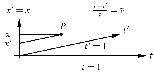

I refer to the video of this page, where there is a description of Galilean relativity that is meant to be an introduction to SR, making the comprehension of the latter easier as a smooth evolution from the former.
All the series is in my opinion excellent, but I think that this aspect is flawed.
It seems that the idea of the video is assuming that also under Galilean relativity there is spacetime as a vector space, composed of time and space vectors, which would be spanned by bases composed of a time basis vector et and another (simplifying the three spatial dimensions into one) ex.
I will explain what the video does, with some adaptations, to make it simpler.
Imagine that the platform is a blue basis and the train is a red basis. The train is displacing wrt to the platform at v = ½ m/s. Event 1 is when the mid-points of the platform and train are instantaneously aligned, and we fix at that point the origins of the two reference frames. Event 2 happens at (common) time t = 2 s, but at x = 1 in the train frame.
To infer the Galilean transformation from red into blue, one can, for example, proceed as follows:
- Measure the (origin) red basis vectors in terms of the (destination) blue basis vectors (assumed to be unitary), as follows:
[tex]\color{red}{e_x} = (\color{blue}{e_x},0) = (1,0)[/tex]
[tex]\color{red}{e_t} = (\color{blue}v{e_x},{e_t}) = (v,1)[/tex]
- Put these values as column vectors of the change of basis matrix:
[tex]\left( {\begin{array}{*{20}{c}}<br /> \color{blue}{x}\\<br /> \color{blue}{t}<br /> \end{array}} \right) = \left( {\begin{array}{*{20}{c}}<br /> 1&v\\<br /> 0&1<br /> \end{array}} \right)\left( {\begin{array}{*{20}{c}}<br /> \color{red}{x}\\<br /> \color{red}{t}<br /> \end{array}} \right) = \left( {\begin{array}{*{20}{c}}<br /> {1*\color{red}{x} + v*\color{red}{t}}\\<br /> {0*\color{red}{x} + 1*\color{red}{t}}<br /> \end{array}} \right) = \left( {\begin{array}{*{20}{c}}<br /> {\color{red}{x} + v\color{red}{t}}\\<br /> \color{red}{t}<br /> \end{array}} \right) = \left( {\begin{array}{*{20}{c}}<br /> {\color{red}{1} + 0.5*\color{red}{2}}\\<br /> \color{red}{2}<br /> \end{array}} \right) = \left( {\begin{array}{*{20}{c}}<br /> \color{blue}{2}\\<br /> \color{blue}{2}<br /> \end{array}} \right)[/tex]
The video also talks about an invariant spacetime interval which would be the arrow joining events 1 and 2, built as the addition of the time and space intervals in each frame, with this mathematical expression:
[tex]\vec S = \color{red}{x{\vec e_x}} + \color{red}{t{\vec e_t}} = \color{blue}{x{\vec e_x}} + \color{blue}{t{\vec e_t}}[/tex]

I believe that it is possible to frame Galilean relativity in terms of geometry and get Newtonian gravity in terms of spacetime curvature. It's called Newton-Cartan gravity, and there's an Insight about it here. So it's a concept with legs, even if not one of the most widely studied.
As @PeroK says, I don't think there's anything mathematically wrong with the concept. And there's nothing wrong with drawing comparisons between relativity and a slightly unusual way of looking at pre-relativistic physics. I agree it's not as powerful a formalism as the metric view of relativity is, but it's probably not without value. If you don't find it useful, though, shrug and move on.
PeroK said:
Did he claim that?
It's clear that in two frames we can have:
$$\Delta t = \Delta t', \ \Delta x = 0, \ \Delta x' = vt$$And, in general, there is no invariant quantity (other than ##\Delta t## itself).

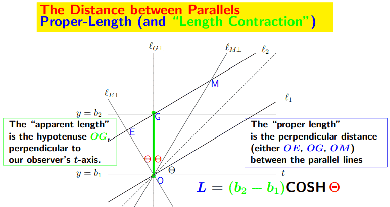

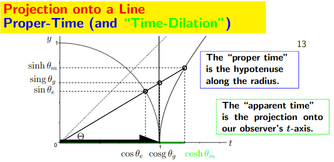

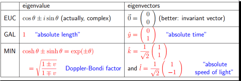

  • Here's my very old poster on "Spacetime Trigonometry" (which I really should write up and publish)
    https://www.aapt.org/doorway/Posters/SalgadoPoster/Salgado-GRposter.pdf
    where the Galilean spacetime has a geometry intermediate between Euclidean space and Minkowski spacetime (in the Cayley-Klein classification of geometries ).
    The above is part of the ancient set of partially-working webpages for the
    "AAPT Topical Workshop: Teaching General Relativity to Undergraduates" (2006) https://www.aapt.org/doorway/Posters/posters.htm and https://www.aapt.org/doorway/TGRU/ ).
  • Attached to the above poster (p. 1-19) is a 2006 draft (on p. 20-27 )
    "Spacetime Trigonometry and Analytic Geometry I: The Trilogy of the Surveyors"
    https://www.aapt.org/doorway/Posters/SalgadoPoster/Salgado-GRposter.pdf#page=20

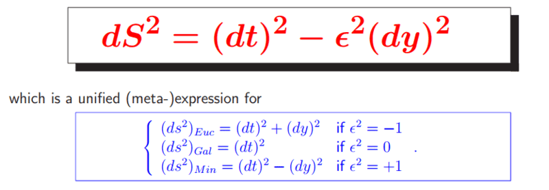

    which distinguishes [itex]c_{light}[/itex] (a conversion constant) and [itex]c_{light}[/itex] (maximum signal speed) and addresses your question.
    (see this ancient post from 2007:
    https://www.physicsforums.com/threads/spacetime-interval-of-zero.180504/post-1402877 )
  • This idea is visualized in my "spacetime diagrammer"
    https://www.desmos.com/calculator/kv8szi3ic8
    where you can vary the E-parameter from Euclidean (E=-1) and Minkowski (E=+1) where Galilean is (E=0).
    In the above desmos visualization, the metric is encoded in the "unit circle"
    $$y^{2}-Ex^{2}=1.$$
  • I have been actively working out aspects of this "spacetime trigonometry" idea to use the Galilean spacetime as a bridge to the Minkowski spacetime, and then, maybe someday, to the de Sitter spacetimes.
    The target audiences would be undergraduates and beginning graduate students.
    The idea is that one can try to formulate and solve a typical physics problem
    in a "unified trigonometric" way using the same [spacetime-informed] intuition,
    which will give the PHY 101 answer in Galilean geometry
    and the PHY 201 answer in Special Relativity,
    using ideas and techniques borrowed from MATH 101 (Euclidean Geometry).
    (The above poster gives examples. I am seeking to apply this to more physics problems.)

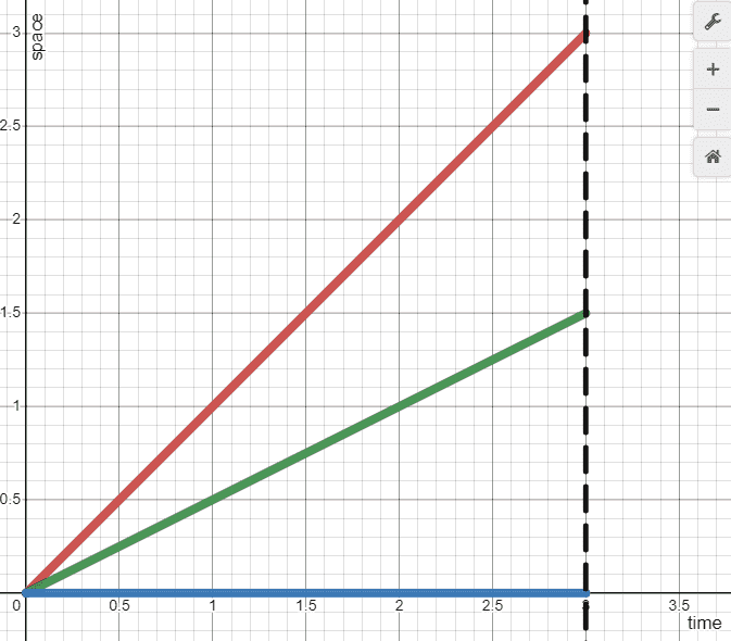

Note that a PHY 101 position-vs-time diagram is an affine space
(in the language in my earlier post)
in that one can use vector displacements (in time and in space)
to get from one point-event to another point-event.
Further, this diagram has a non-euclidean geometry
For convenience, let us measure time in seconds and space in units of light-seconds.
(It doesn't matter that the "the speed of light" (as a "maximum signal speed") isn't an invariant in Galilean physics. I am using it as a "conversion-constant".
I could use "sound-seconds", where "1 sound-sec" is 343 meters.
But since my eventual goal is special relativity, I'll choose "light-seconds", where "1 light-sec" is 299792458 meters.)
There are 4 displacement vectors to consider
[itex]\vec v_{B}=3\hat t +0 \hat y[/itex]
[itex]\vec v_{G}=3\hat t +1.5 \hat y[/itex]
[itex]\vec v_{R}=3\hat t +3 \hat y[/itex]
[itex]\vec v_{S}=0\hat t +1 \hat y[/itex]
There is a Galilean spacetime geometry underlying the PHY 101 position-vs-time diagram.
  • Let me define a Galilean dot-product as follows
    [tex]\vec A \stackrel{G}{\cdot} \vec B = A_tB_t[/tex] which implies a temporal-magnitude [itex]|\vec A|_G=\sqrt{\vec A \stackrel{G}{\cdot} \vec A}[/itex].
  • This dot-product, however, will assign zero to all vectors with zero time-displacement.
    We need another dot-product to assign nonzero magnitudes to these vectors.
    So, we define a second dot-product as follows
    [itex]\vec A \stackrel{S}{\cdot} \vec B = A_yB_y[/itex]
    which implies a spatial-magnitude [itex]|\vec A|_S=\sqrt{\vec A \stackrel{S}{\cdot} \vec A}[/itex].
  • Note that we could do the same construction with a PV-diagram from thermodynamics.
    (I am not pursuing any attempt to develop for the PV-diagram
    what I am about to do for the PHY101 position-vs-time diagram.)
  • Yes, these dot-products are "degenerate" (nonzero vectors may be assigned zero magnitudes),
    which complicates some constructions. However, we proceed carefully.

In this line, I said that a spacetime interval defined (like in the reference video) as follows...
is good for nothing, since it does not solve any practical problem.
For clarity of terms and notation, you are describing a displacement-vector in the spacetime-diagram.
The interval or squared-interval is an assignment of a size or [possibly-signed] number to a vector using a dot-product (or associated metric) which is to be preserved by associated rotations or boosts.
Vectors like your [itex]\vec S[/itex] can be used to describe the tangent-vectors to worldlines in the diagram.
With the help of the dot-product, we can normalize the tangent vectors to obtain the Galilean analogue of the so-called 4-velocity for that worldline.
One can think of the size of this 4-velocity as one tick on the worldline's clock, and the direction is obviously important to describe the motion of various objects.
So, even though all Galilean 4-velocities have the same magnitude (same interval) given by the dot-product [itex]\stackrel{G}{\cdot}[/itex] (as defined earlier in #15), such unit-displacement vectors [itex]\hat S[/itex] are useful for practical problems (but one has to know how to use them to appreciate them).
Admittedly, many geometrical constructions may look trivial in the Galilean case.
But this is a warm up to Special Relativity, using the same geometrical constructions with a more complicated dot-product. Again, if one didn't care about Special Relativity, then this is likely of little value.
A useful calculation is to find the eigenvectors
  • of the rotation matrix. (There are none.)
  • of the Lorentz boost (in 1+1 Minkowski).
    There are two, and they correspond to the maximum speed of signal propagation (which happens to also be the speed of light) in the forward and backward directions. The eigenvalues are the Doppler factors.
    (This is the invariance of the speed of light).
    There are no timelike eigenvectors. (This is the principle of relativity.)
  • of the Galilean boost (in 1+1 Galilean).
    There is one, and it corresponds to the infinite maximum speed of signal propagation in Galilean physics. The eigenvalue is 1, and it can be associated with absolute-length in Galilean physics.
So, again, in spite of Galilean-vectors not "mixing" space and time in the dot-product or spacetime-interval,
Galilean displacement vectors, which do have time and space components, (e.g. Galilean 4-velocities) are useful for practical problems.
Above you say that the eigenvector of the Galilean boost is the infinte speed. I preferred what I read in your draft paper (see below) which is that the eigenvector is absolute time. I was going to comment that for me that was something that had always been in the back of my mind. Is there a mistake somewhere or did you change your mind?

The spacetime interval that I mentioned (yes, a spacetime displacement vector) is what the author of the video claims to be the invariant interval of Galilean spacetime.
There are some conceptual errors that have to be resolved before we continue.
  1. Displacements in spacetime are vectors [itex]\vec S=S_t \hat t + S_y \hat y[/itex] that can be used to move from one point-event to another point-event in a position-vs-time diagram (a spacetime diagram). (Vectors can be scalar-multiplied and added according to the parallelogram rule.)
