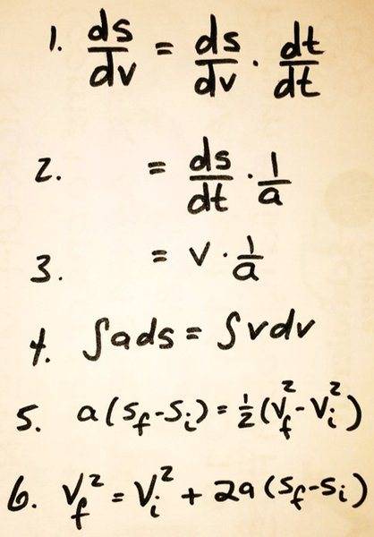

The discussion focuses on the derivation of equations for Uniform Accelerated Motion (UAM), specifically addressing the term ds/dv. The derivation presented is a concise formulation of the acceleration equation: a = dv/dt = (dv/ds)(ds/dt) = v(dv/ds). It clarifies that ds/dv is the reciprocal of dv/ds, although its fundamental significance is minimal. The conversation emphasizes the utility of this derivation in understanding motion dynamics.
