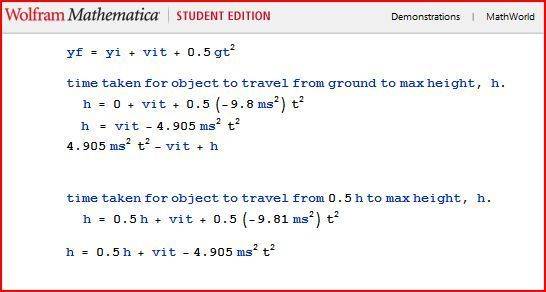

Should I find the first derivative of yf and determine the local max? And what does upper half implies? The max time take for the object to travel from ground to max height?
Edited: If h is the maximum height of the jump, you want to find the ratio of the time to travel the upper half (from y = .5h to the max height y = h and back to y = .5h) to the total time to travel from the ground and back to the ground.
By finding the quadratic roots of each of the equation, and taking the time taken for the object to travel up from ground to max height,h and from 0.5h to ma height, h, its possible to find the ratio.
However, I'm unable to reduce the quadratic equations to their respective roots without any numerical values for vi in place.
You did not use the fact that h is the maximum height reached when the object is launched with vi.
You need to express the time as a function of h (and g) only. So eliminate vi first.
And of course, in the second equation the initial speed is different. Using the same "vi" for both is confusing.

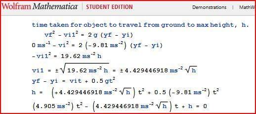

https://www.physicsforums.com/attachments/64943
Is this right?
In going from the 2nd to the 3rd line, did you multiply 2(-9.81) correctly?
Don't forget the equation vf = vi + at
Corrected the blunder.
Is it not possible to solve it via quadratic?
For this problem, there is no need to plug in values for g.
You have 02 -vi2 = -2gh.
What do you get if you solve this for vi in terms of g and h?
Yes, you can work with the quadratic equation in t, but it is easier to work with the linear equation.

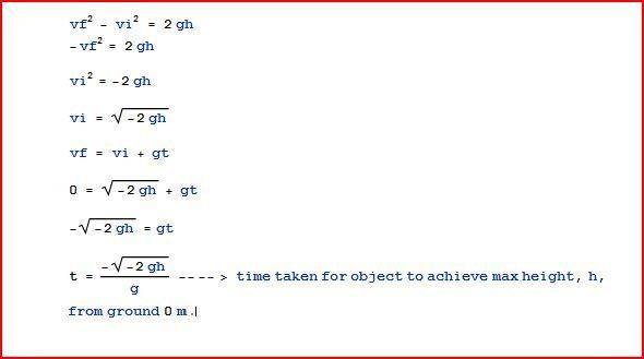

Your result ##t = -\frac{\sqrt{-2gh}}{g}## is correct (assuming your convention that ##g## is a negative number).
With the usual convention, you would have ##t = \frac{\sqrt{2gh}}{g}##. You can simplify the result by taking the ##g## in the denominator inside the square root and doing some canceling.

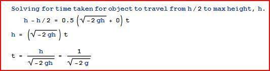

Now that we have the time taken for object to travel from 0m to height, h.
In determining time taken for object to travel from h/2 to height, h.
Look at your first equation: ##h -h/2 = .5(\sqrt{-2gh} + 0)*t##. It appears that you are saying that the displacement equals the average velocity multiplied by the time. That's one way to get it. But what does ##\sqrt{-2gh}## in this equation represent?
It represents vi.
Does vi here represent the velocity at the ground level or the velocity at h/2?

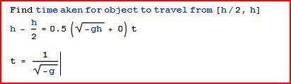

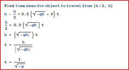

vi represents velocity at position h/2
OK, vi should be the velocity at h/2. But the expression ##\sqrt{-2gh}## is not the velocity at h/2, it's the velocity at the ground.
tsny said:
ok, vi should be the velocity at h/2. But the expression ##\sqrt{-2gh}## is not the velocity at h/2, it's the velocity at the ground.
OK. Note that the 2's will cancel in your final expression.
Is there a single equation that allows me to determine the change in vi as the object travels from 0m to h/2 without having to produce the above equation?
Seems like that question is leading us aside. We have a couple of choices. We can continue your line of thinking (which is getting you pretty close to the result) or we can step back and start all over with a different approach that will lead to the answer with the least amount of calculation (for example, haruspex's method).
Which would you like to do?
