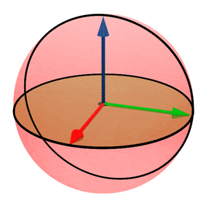

Kashmir said:
I am not keeping theta the same. I'm keeping the other two same and vary theta
That is not what I wrote, sorry.
If you increase theta by 90 degrees, for example, the value of the other angle respect to vector r must change.
As you tilt the z axis, you are simultaneously rotating it around the x-axis and around the y axis.
Because of that, the x-y plane tilts about an axis that crosses the origin and is perpendicular to vector r.
When all the above happens, the length of the projection of vector r on x-y plane changes, making change the projections of vector r on the x-axis and on the y axis, even when the spatial position of vector r and its absolute magnitude remain the same.
An example would be to assign x, y and z axes to three edges of a carboard box.
Looking directly from above, you will see and angle of 90 degrees between axes x and y.
Now, as you tilt edge z back diagonally to edges x and y, you could see how the angle between edges x and y increases until reaching 180 degrees when edge z reaches the ground: your phi angle has naturally changed.
Kashmir said:
So we can't rotate in such a way that changes theta but keeps r and phi the same?
The value of r remains unchanged, but its projections on the three planes change (please, see attached animation).
The value of phi is affected by the rotation of the three axes, as well as it happened to theta.
Perhaps I am wrong, but I believe that:
1) The particle with mass m is located at the origin of coordinates x-y-z.
2) Vector r is the spatial velocity of mass m.
3) Theta and phi are angles that can define the spatial location of r because those angles are contained in planes that are perpendicular to each other.
