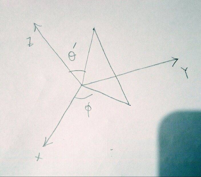

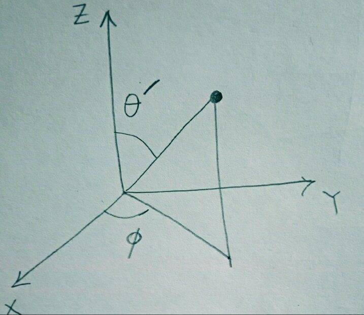

A free particle with coordinates as shown has kinetic energy ##T = \frac{1}{2}m\left(\dot r^2 + r^2\dot\theta^2 + r^2\sin^2\theta\dot\phi^2\right)##
So we see ##T## depends on ##\theta##.
Now suppose we rotate our coordinate system such that only one coordinate ##\theta## changes from ##\theta## to
##\theta'## and fix it there as is shown in figure below. In this coordinate system the kinetic energy should be the same as before since the kinetic energy should be same in all inertial frames.
However if we substitue values of ##r, \theta',\phi## in the formula for ##T## we will get a different value of ##T## hence a contradiction.
Can anyone please tell me what is wrong. Thank you.

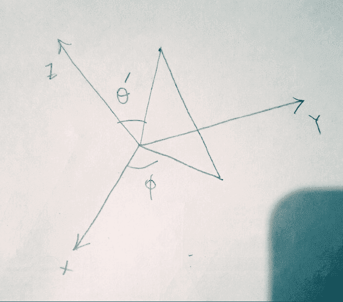

Suppose I've rotated my coordinate system such that only ##\theta## changed to ##\theta'##. This will look like the figure shown
Isn't it correct till now?
Kashmir said:
Suppose I've rotated my coordinate system such that only ##\theta## changed to ##\theta'##. This will look like the figure shown View attachment 290785
I don't see any rotation there. I just see spherical coordinates.

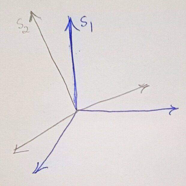

Yes ,even x, y will be different. I've shown the two systems in this figure below. S2 is the rotated one
Perhaps this might help. What you can always write is $$T = \frac{1}{2}m\left(\dot r^2 + r^2\dot\theta^2 + \rho^2\dot\phi^2\right)$$where ##\rho## is the projection of ##r## on the ##xy##-plane. In this form, you can see the "decomposition" of the kinetic energy into the sum of three terms, radial, meridional (if that's what it's called), and azimuthal.
With your new ##z## axis, you no longer have $$T = \frac 1 2 m (\dot x^2 + \dot y^2 + \dot z^2)$$That is only valid for mutually orthogonal Cartesian axes. You can't change something like the z-axis without changing the formulas that involve the z-coordinate.

I've rotated the whole set of three axis, keeping them orthogonal during the rotation. The rotation is such that only theta changes. The mutually perpendicular axis are shown here with the only change in the coordinates of the particle being in ##\theta##
Kashmir said:
I've rotated the whole set of three axis, keeping them orthogonal during the rotation. The rotation is such that only theta changes. The mutually perpendicular axis are shown here with the only change in the coordinates of the particle being in ##\theta##View attachment 290790
That's still simply the usual spherical coordinates. Except you've chosen to use ##x, y, z, r, \phi## but used ##\theta'## instead of ##\theta##.

OP, what you may not realize is that when you make that coordinate rotation, although φ does not change, dφ/dt does.
Consider two objects on the surface of the Earth (assumed a perfect sphere), both on the Greenwich meridian (same r and φ) but one near the north pole and one near the equator. Suppose they both move at V m/s eastward along their respective lines of latitude. What is dφ/dt in each case?
So in your equation for KE, it's not just θ that changes, but also dφ/dt.
