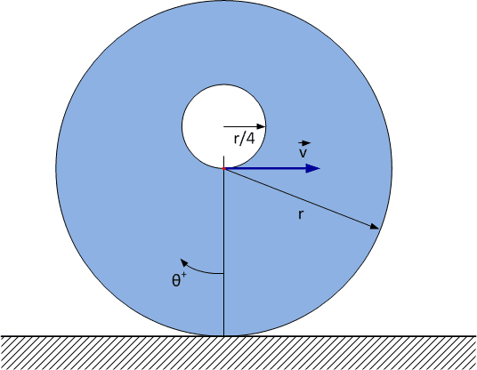

In a uniform solid cylinder of radius r, mass m and height h we emptied a cylindrical cavity of radius r/4 tangent and parallel to the symmetrical axis z of the original cylinder.
The cylinder is rolling without slipping on a horizontal plane. Find the kinetic energy in terms of θ and θ' where θ is the angle between vertical and the line joining the center of the original solid cylinder and the center of the cavity.

My side view of the cylinder (which you have drawn for yourself, I should hope) is as folllows:
##\omega## is indeed ##\dot \theta r ## as you expect.
[edit] oh boy! see post #3 o:)
Do you think the mass of the rolling object is ##m## as in the problem statement, or is it ##{15\over 16}m## ?

You don't need to any integration for this problem, just apply standard results.
I would not bother finding the common mass centre. Just treat the motion as rotation about the rolling point, so find the moments of inertia about that point.

Treat the hollow as a negative mass cylinder, same density, combined with a normal complete cylinder.
Each has a moment of inertia about the point of contact with the ground, and you can find these using standard formulae.

A few problems with that term. How far is the centre of the cavity from the point of contact?
(It's not clear from the problem statement whether theta is measured from the upper radius or the lower radius. I.e. at theta=0, is the cavity above or below the middle of the cylinder?)

http://imageshack.com/a/img911/1145/CawDxl.jpg
This is an approximate sketch of the situation and how i calculate the distance. C is the contact point.
BD= r/4 sinθ
AD=r/4cosθ
So BC=sqrt( (AC-AD)^2+BD^2 ) = sqrt( (r-r/4cosθ)^2 + (r/4 sinθ)^2 ) = sqrt( r2-2r2/4 cosθ + (r/4)2) = sqrt( 17r2/16 -r2/2 cosθ)
BD= r/4 sinθ
AD=r/4cosθ
Good, you got 17/16 this time, which is what I have. The other difference was because I was measuring theta from the upper vertical radius, whereas you show it from the lower.

The total moment of inertia at the contact point is Itot= 3/2Mr2+mr2/32+17mr2/16-mr2/2 cosθ = 3/2Mr2+35mr2/32-mr2/2cosθ
m=-1/16M
Itot=3/2Mr2-35Mr2/512+Mr2cosθ/32
Is my Itot correct ?
I think that's right. Of course, you can combine the first two terms.
