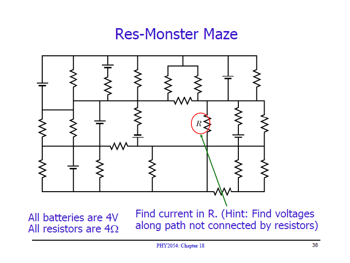

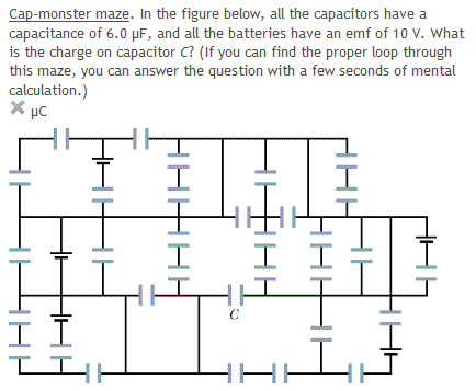

Well, the attachments says it all, the cap-monster and res-monster maze. I want to know if I made a right decision about my answer.
Cap-monster maze
ξ - q/C = 0
Then q = 60(nano)Coulomb.
Res-monster Maze
1 - ξ2 - ξ3 - ξ4 + IR = 0
I = 4A.

Mastur said:
Cap-monster maze
ξ - q/C = 0
yes (except for the nano)
Res-monster Maze
nooo :wink:
I already got the Res-monster maze.
The problem is the one battery, which will have a positive sign. So the answer is 2A. :)
And what's with Nano? Hmm? But my answer is correct, right?
Naah, I got it. It's MICRO, not NANO, right? hahaha

the answer for the cap-monster cage is 15 micro coulombs. don't feel like explainin it cause I am a lazy bum but you should def trust me!
garbagesocray
"the answer for the cap-monster cage is 15 micro coulombs. don't feel like explainin it cause I am a lazy bum but you should def trust me!"
You are wrong garbagesocray . Try considering a loop in which there is only the capacitor C and the Battery(s).
Happy Solving :)
