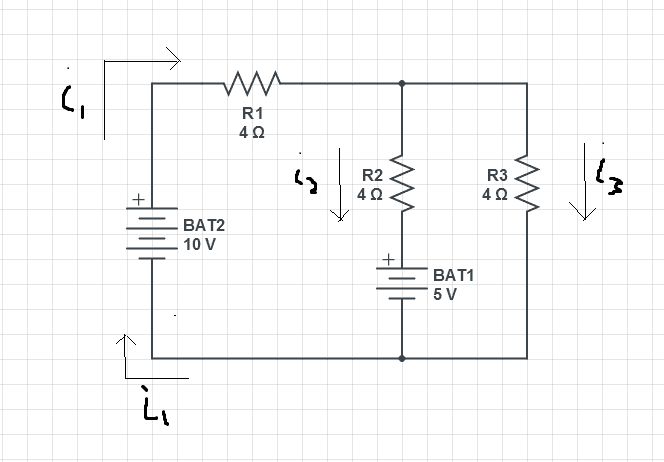

Circuit schematic with two batteries and three 4 Ω resistors: BAT2 (10 V) on the left branch, R1 on the top wire, R2 and series BAT1 (5 V) in the middle branch, and R3 on the right. Currents labelled i1, i2 and i3 with arrows.
What are the sizes and directions of the currents through
resistors (a) R2 and (b) R3 in Fig. 27-42, where each of the three resistances is 4.0 Ω?
ΔV=IR
Equations:
1) ΔVB2 -(i1)R1 -(i2)R2 -ΔVB1=0
5V - 4(i1) - 4(i2) =0
4(i2)=5V -4(i1)
2) ΔVB2 -(i1)R1 -(i3)(R3)=0
10V -4(i1) -4(i3) =0
-4(i3)=-10V + 4(i1)
not sure about this one
3) ΔVB1 -(i2)R2 -(i3)(R3)=0
5V + 4(i2) -4(i3) =0
4) i1=i2 + i3
5V +5V -4(i1) -10V +4(i1)=0
0=0
I'm not really sure what to do here.

The blue equation is not independent from the previous ones. Use eq.4 to find i1.
ehild
I also suggest superposition:
solve for the currents with one battery shorted, solve with the other battery shorted, then add the results.
